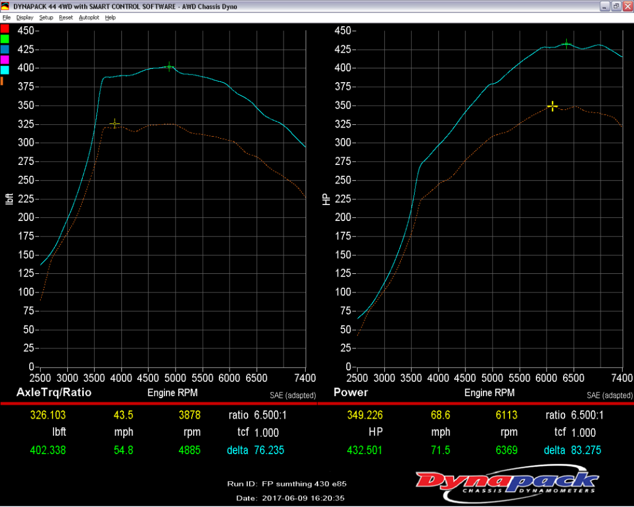

Here's my 91 tune (lower power curves). Since it was dual mapped, they idiot proofed as much as they can for me since I'm new to E85...I think they kept boost to 24 psi on 91. My previous tune was by Vishnu and spikes wentup to 26 psi.
350hp/325tq.
Mods: 71hta, Perrin TBE (from Vishnu V400), 3-port boost controller, 1200cc injectors, AMS FMIC, 320 lph fuel pump, Injen hard pipes, crushed DV (works great!), MAP O2 housing, and I ported exhaust manifold and turbo hotside myself with help from many people on this site.

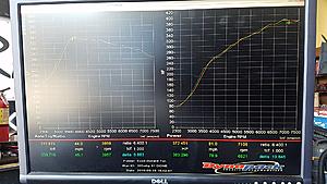

Update with 7009 S2 cams and 5041 springs/retainers
Since last post, I've added S2 with 5041 springs/retainers. I also upgraded to Exedy Twin Disc clutch, catch cans, and Evo 8 3rd & 4th gears (dynoed with break in gear oil, which will be switched out to Redline Cocktail in a few weeks).
Orange is old 91 tune with stock cams. Green is new 91 tune with S2 cams.

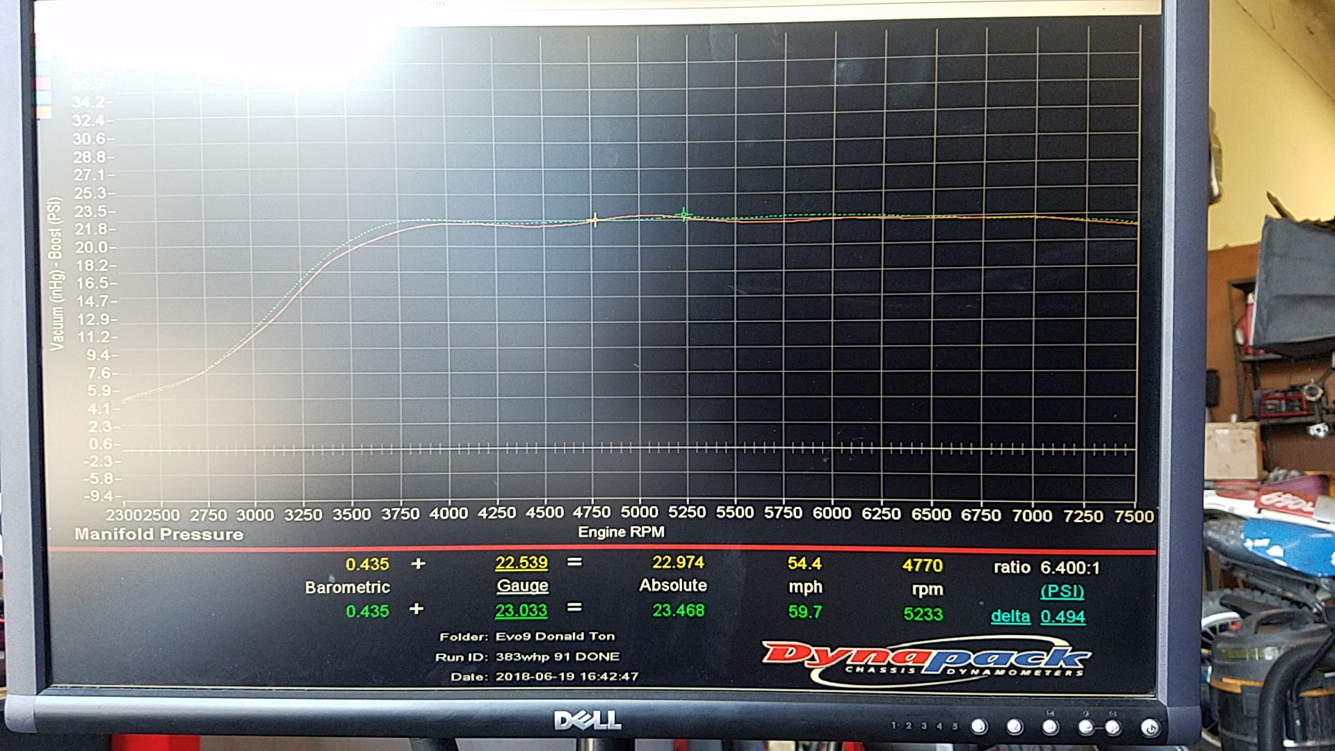

Since last post, I added oversized valves & mild head porting.
