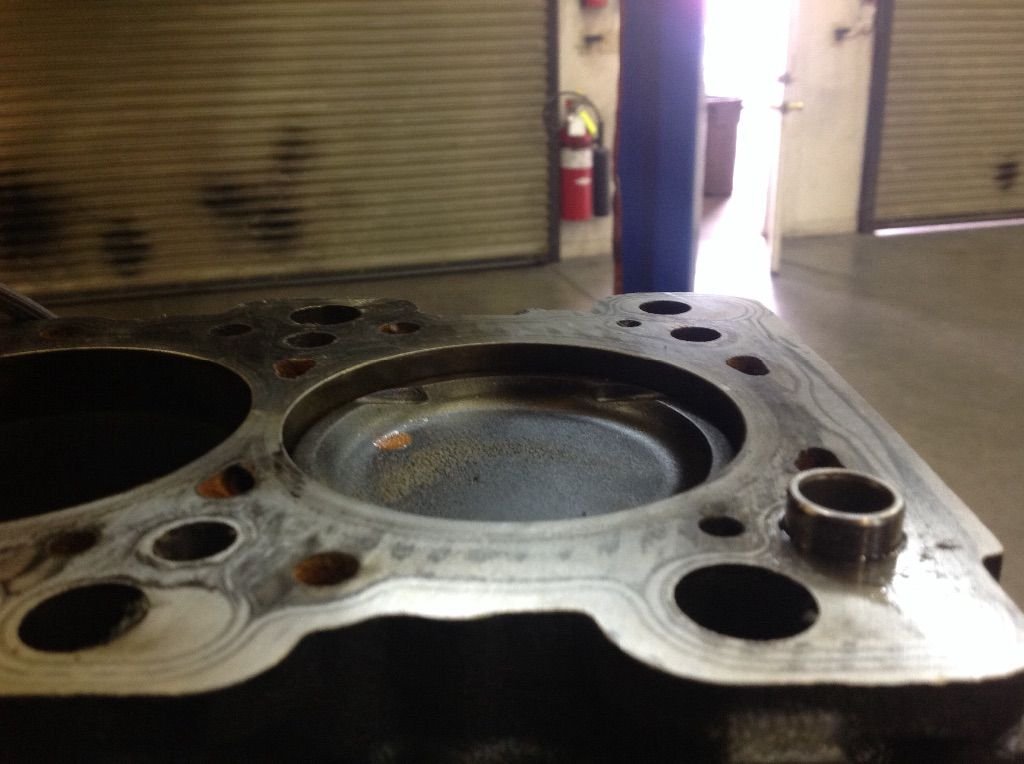

Imagine our surprise when the head came off and we saw this -
The previous "shop" had made the mistake of putting 2.3 pistons in a 2.0L without using 156mm rods. The resulting compression ratio calculated out to around 5.9:1, great for a 1960s VW beetle but insanely low for an Evo. No wonder the car had 90psi of compression and made 574whp at 37psi and GSC S2s.
