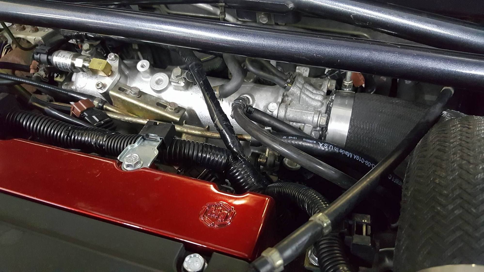

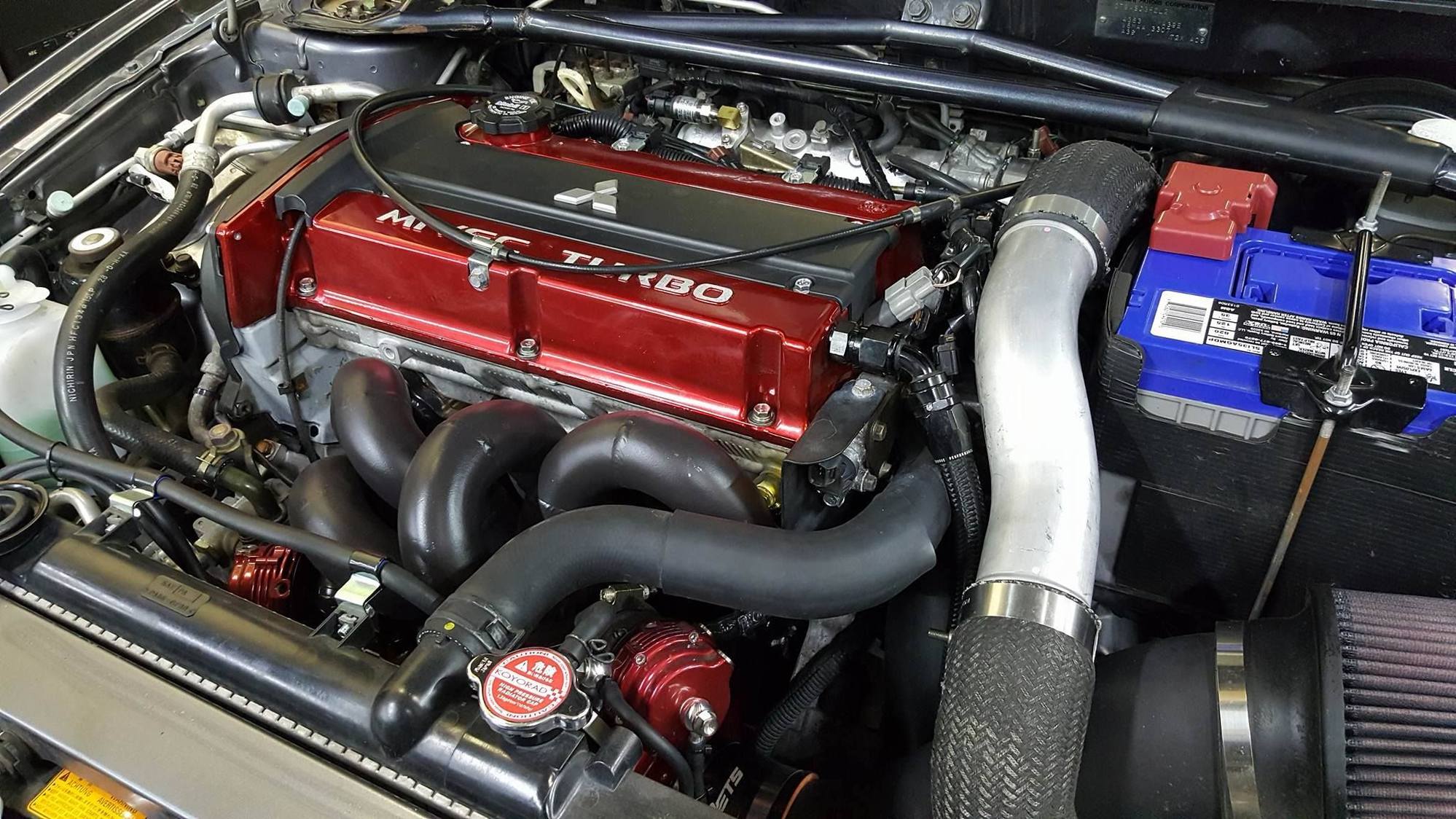

The car came apart for one of our SLR2.2 but this was more in the flavor of the first 2.2 I built in Nov 2009. 4G64 block, long rods, 9.5:1 compression, GSC R2s, Fuel Injector clinic 2150s, worked head, etc. The main differences are this has a Curt Brown ported stock intake manifold and STOCK UPPER INTERCOOLER PIPE. Providing the airflow is an ETS 6466 V band kit with 0.82 housing and ETS intercooler.
We have finally started using the AEM Infinity as well, this car featuring the 506 with AEM jumper harness and our 12 tooth Evo IX specific trigger wheel. While the car is flex fuel we didnt really spend a bunch of time on the pumpgas as he intends to keep it mostly on E85 and only rely on the flex side for road trips. Since the boost is 15psi on pump (to save him from himself) the car was only making low 400s.

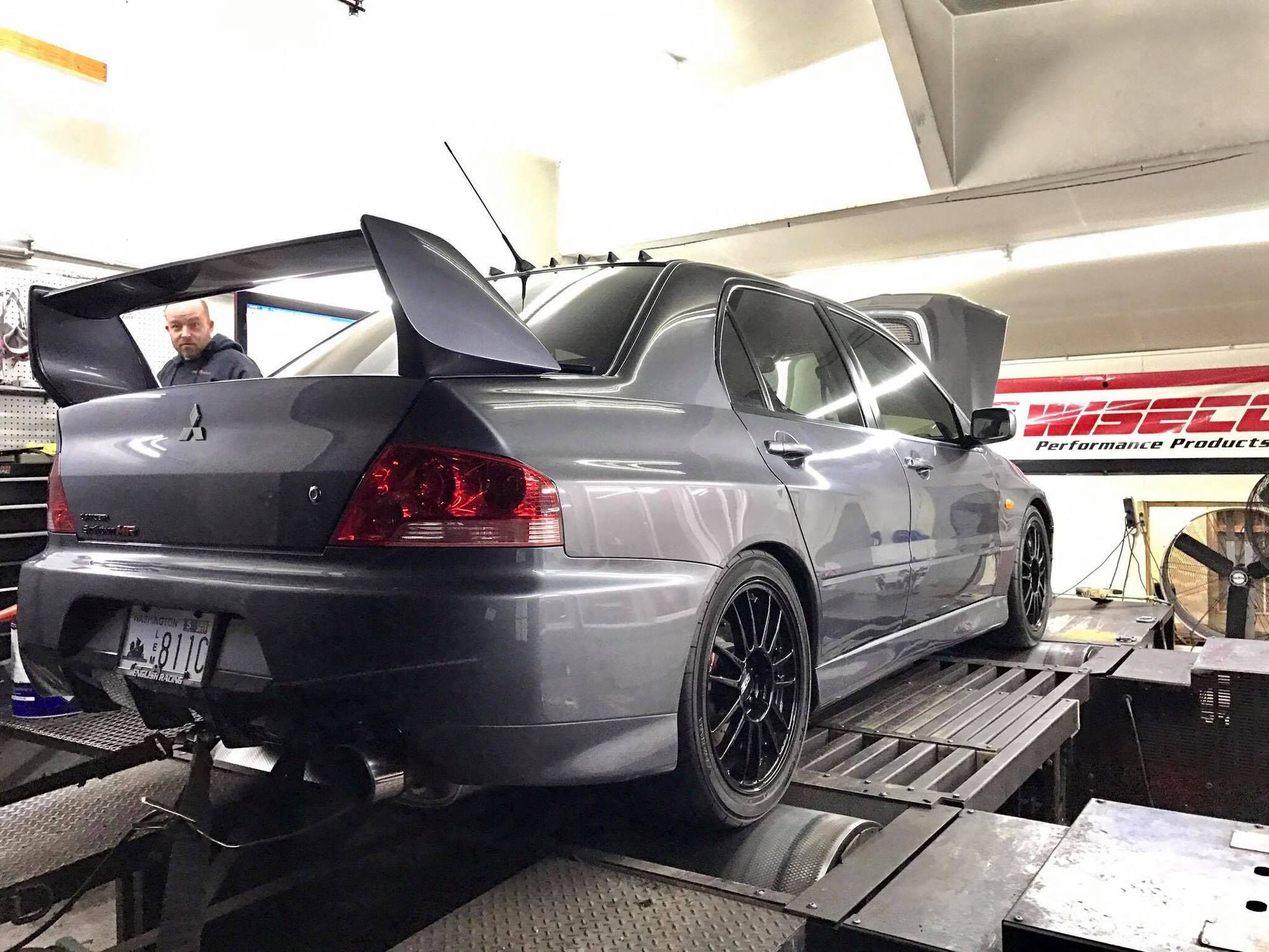

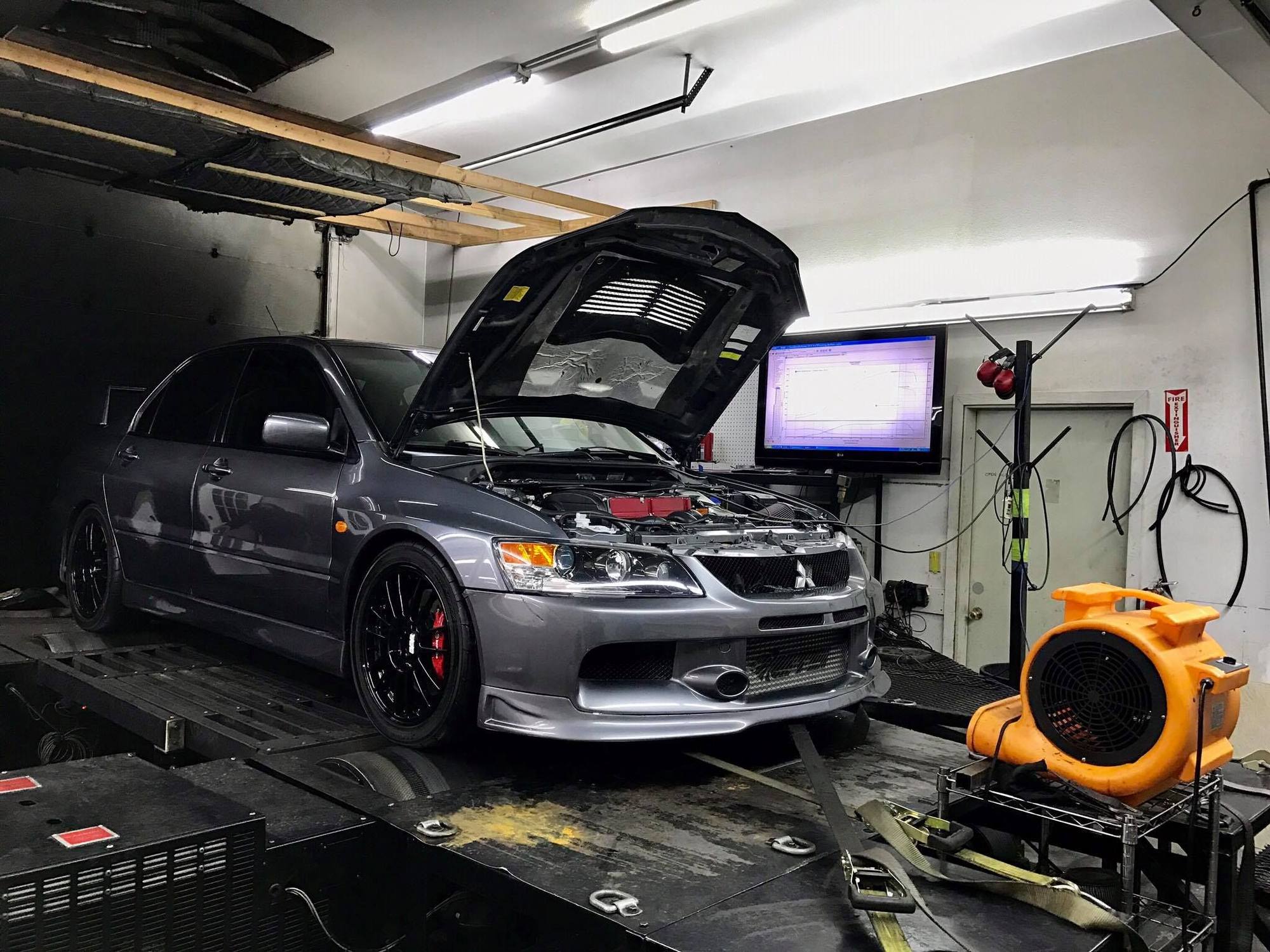

Dyno sheet, 3rd gear, 38-39psi, E83
Clean ex MR
FIYA
Stock appearing
