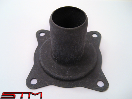

hi, anybody here know how many torque specs of this 4 bolts of the reteiner trans??
Thanks a lot
