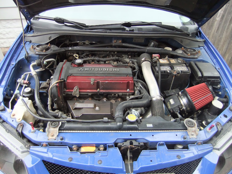

May 2010- Ever since joining the forum in February I was always intrigued by the thought of learning to tune, so I started reading just about every thread possible that was related to tuning. At first, I was scared to death to even try hooking up a Tactrix Cable But the more I read and talked to people, the more comfortable I got and I eventually bought my first Tactrix Cable in May of 2010. I started out by just doing some logs in Evoscan because I still had no idea what I was looking at in EcuFlash, and things slowly progressed from there.
Pic of the Engine Bay May 2010. The manifold and IX DV were the only changes from the day I bought it:

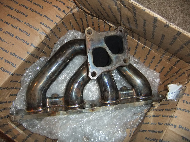

June – August 2011- June and July were spent mostly gathering parts for the turbo swap. For financial reasons and due to the fact that I daily drive my Evo, going with a IX turbo was an easy choice for me. I knew it would give me a nice little bump in power, but not so much that I was going to have to worry about blowing a motor any time soon. I ended up finding a great deal on EvoM for the turbo and I also came up with good deals on a MAP Short Runner Manifold, an FP 18 psi WGA, and some brand new ARP headstuds. Here’s the pics of the goodies:
IX Turbo with FP 18psi WGA and E-Bay O2 Housing
ARP Headstuds
Everything ready to go the night before the turbo swap

Engine Bay in it’s Current State
