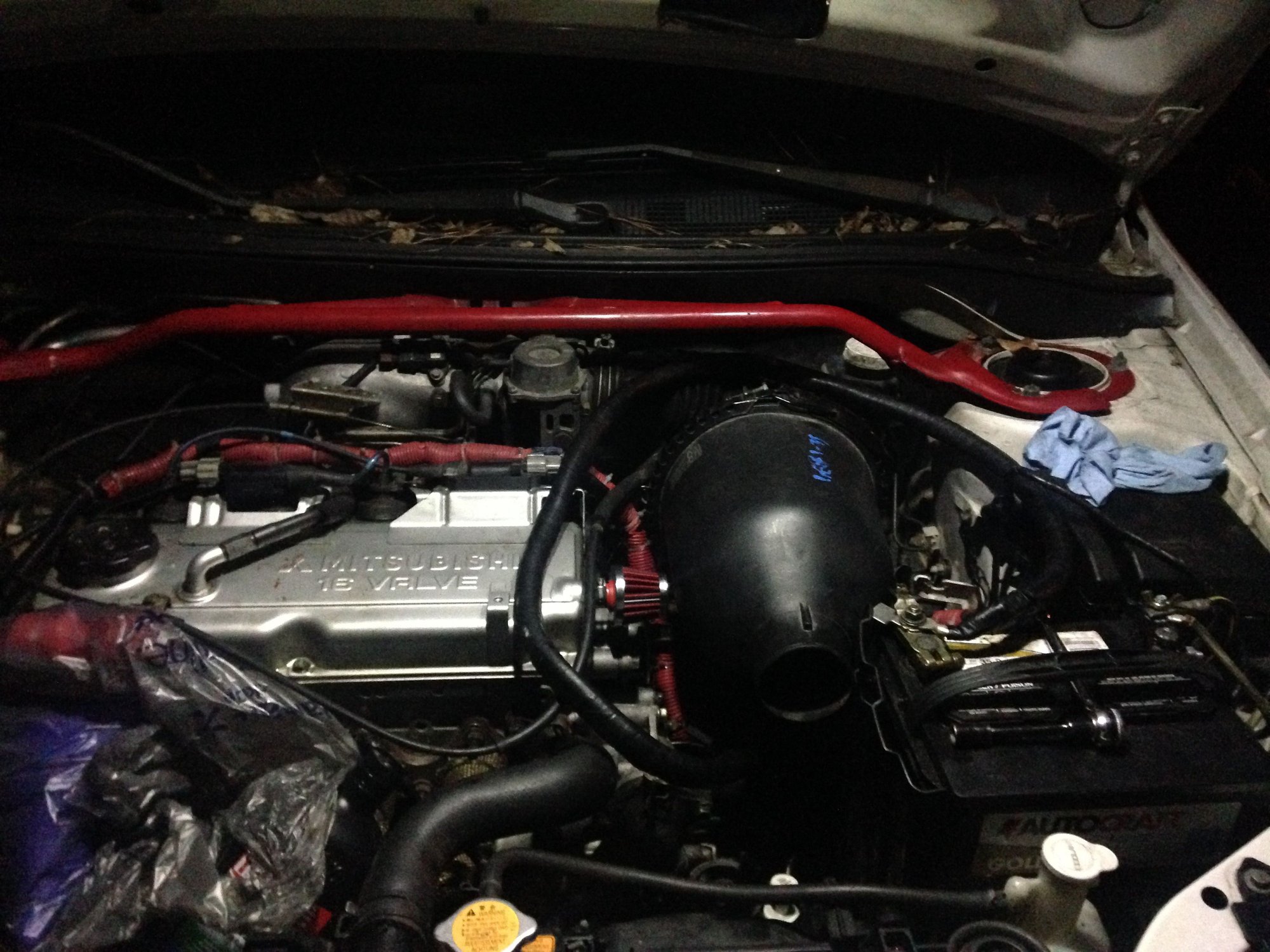

While waiting for my new radiator to come in, for cause of a transmission line leak, I finally got the pieces together to fab up a ram air intake yesterday and covered it on YouTube, then testfitted it today. So far, so good.
Just have to get a bracket fabbed up so it's not flopping around while I'm driving, finish cutting the airbox to accept the tunnel/chute, and then grow the kahunas to start cutting the hood for the final product.

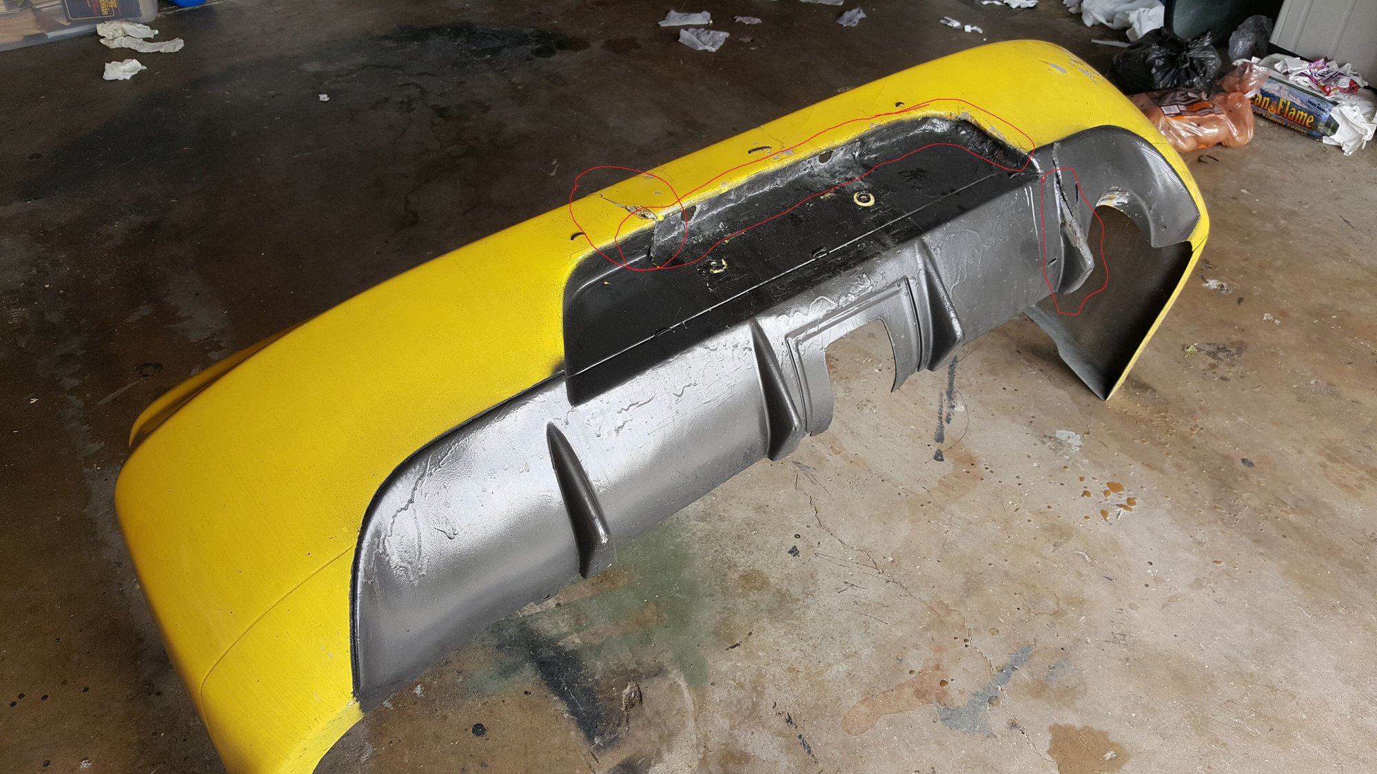

[ 56 Warning ] JDM EVO9 Rear Bumper
Unlike the evo7 front that is in far worse shape and beyond repair (waiting on rrm to see if their front can be split from the kit ), this one ( rear )is worth my time to save. Nothing wrong with the ED version i have, the accolade version fits better and is closer match tp the real one for evo9...
the plan is to re-fiberglass the areas marked in red in several layers with mesh reinforced from the rear. bondo the top, sand it out then repaint...
plain is to have this fixed my mod17 and looking like it was before the accident...

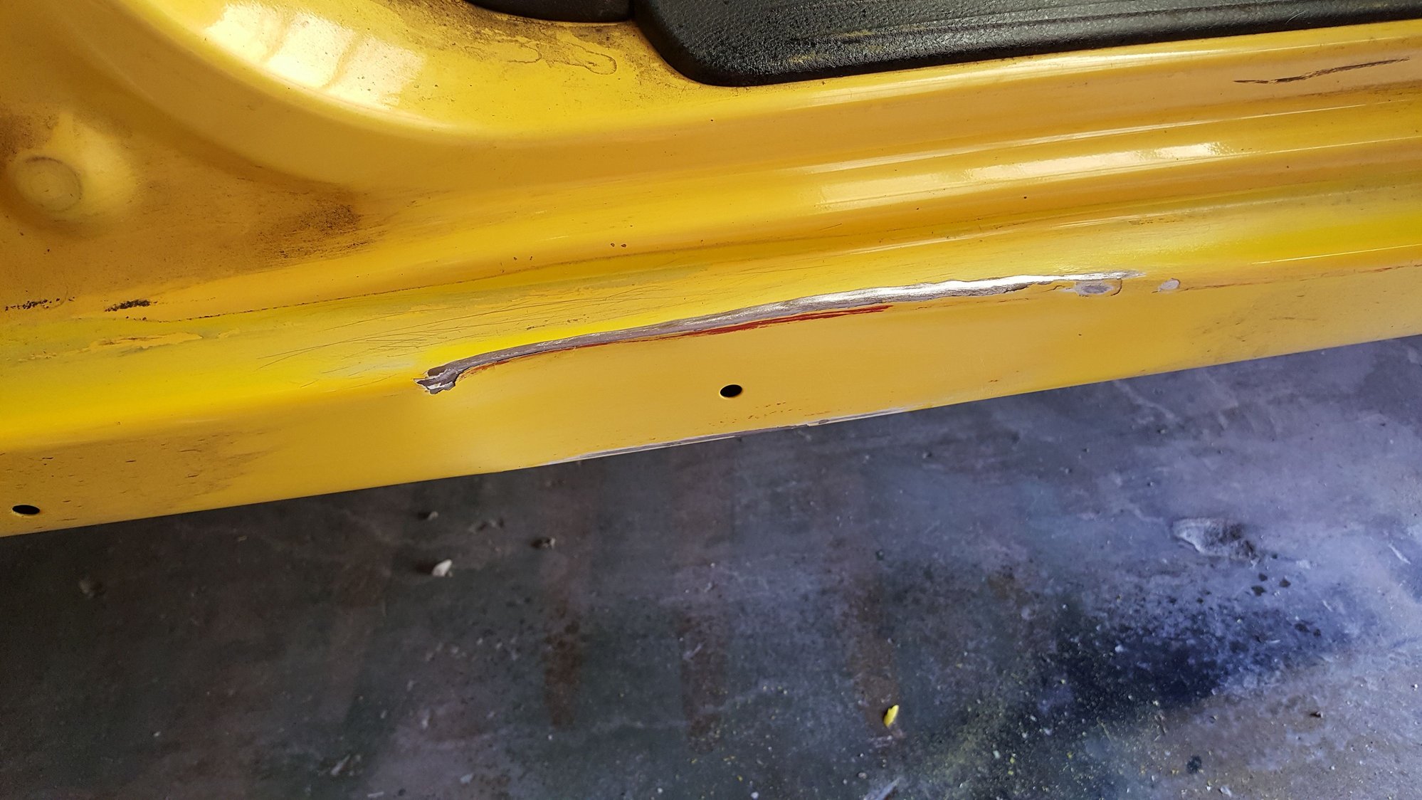

So while I was waiting for primer to dry on rear bumper, I started to repair this dent that the stupid old man indirectly hit my car. I used a hammer to bang it back into shape. sanded with 60/80grit, shot some etchin primer then filled in with gold bondo once dried. once it dried, I used more of grey primer as a guide to see where I need to fill in. its almost straight, I need to work on filling in the dent on door next

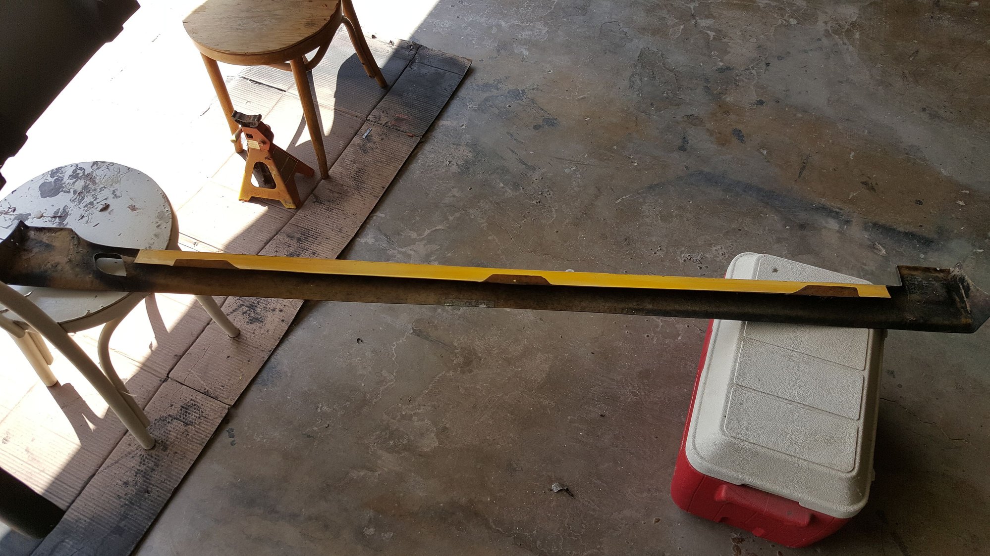

found a replacement evo7 bumper to match my hood. i just hope it lines up with accolade hood.... i started to dryfit the accolade sideskirts i had in storage for years, this will help hide damage to the passengerside door. bought them from murphdurph when he was still in san diego...

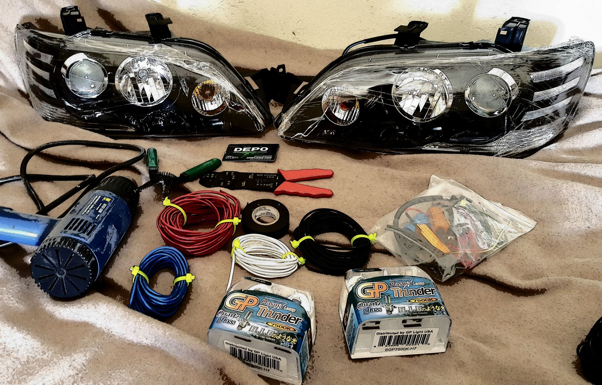

ahh yeaaah, finally got new headlights delivered today, gotta love 2 day shipping ground from la
now to re-wire , swap the turns and parking lights on these before I install them in the car but
that wont happen until I get new bumper installed and whole car painted, no way these will
be on car when its in the shop, along with new tail lights

thy are made by depo, dot compliant and made for 2002-2003 lancers only... my other ones like this got damaged in a accident last year, lows don't work, I have been using hi-beams to drive at night, witch sucks even tho both are aimed down to normal levels so it doesn't shine into another cars rear window..
and my passenger side light is cracked in 3 spots badly and duc-taped together lol
