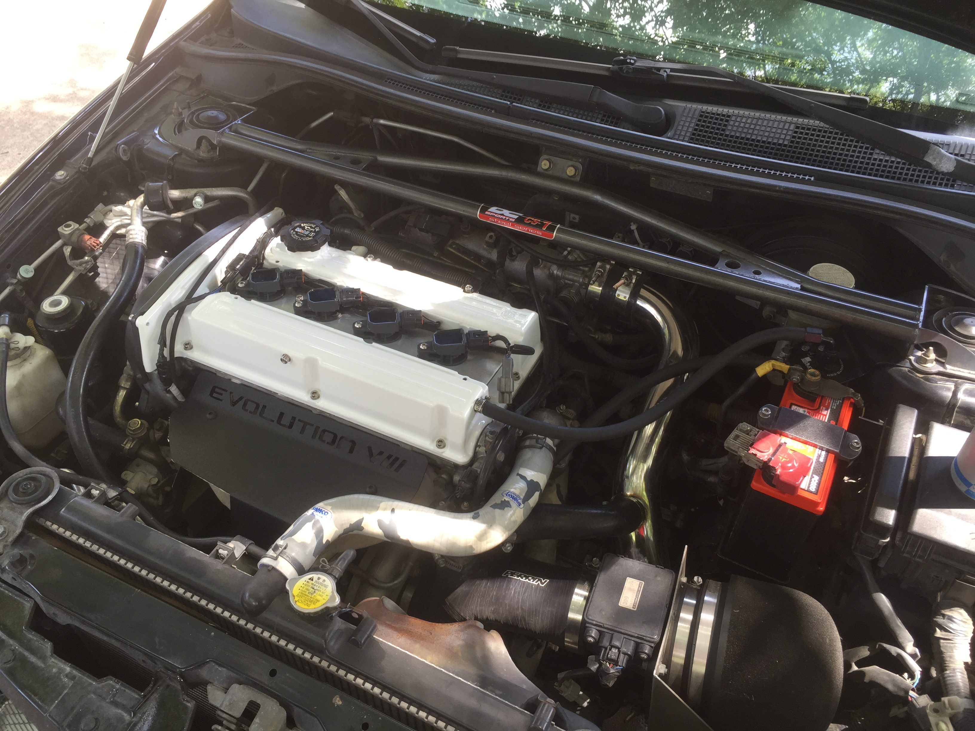

GSC S1s went in a few weeks back. PCV side Radium Auto catch can went in and is working. Checked it yesterday and it needs emptied. Intake side has been dry for months. I'm building a better boost leak tester and ordered a different set of plugs. Car is strong but might be getting some spark break up on occasion.
Injectors and suspension are next on the list. Slowly working on my intake manifold before sending it in with a throttle body for porting. I want to do the 84mm FP cover and a 4 inch velocity stack intake with SD this next year. Going to try to push as much as I can out of the IX turbo.
For those that have asked, the exhaust manifold cover was off eBay. You can get whatever you want stenciled in there, but I just like what it said in the stock photo. I have gold reflective tape on the back and my exhaust manifold is Swain coated. Underhood temps seem better than before, honestly.
