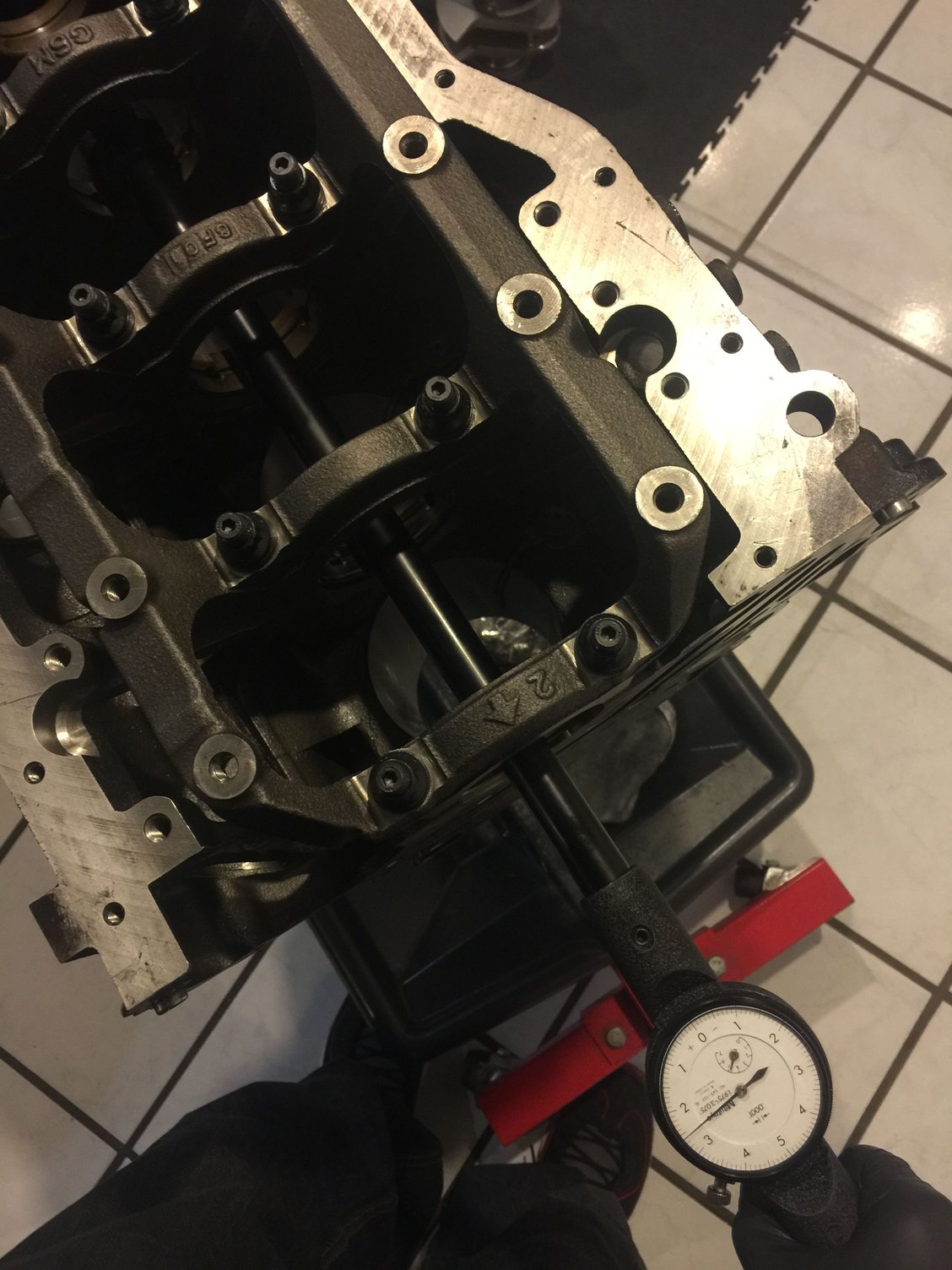

Here im measuring the line bore to make sure its straight after ARP main studs are torqued down before the block is off to the machine shop. (We measure BEFORE and AFTER).
Here's a different block back from the machine shop I am checking main bearing clearance on. We measure every aspect of the engine. We never just put an engine together without verifying the clearances. This assures 100% no way possible for errors to occur on our builds.

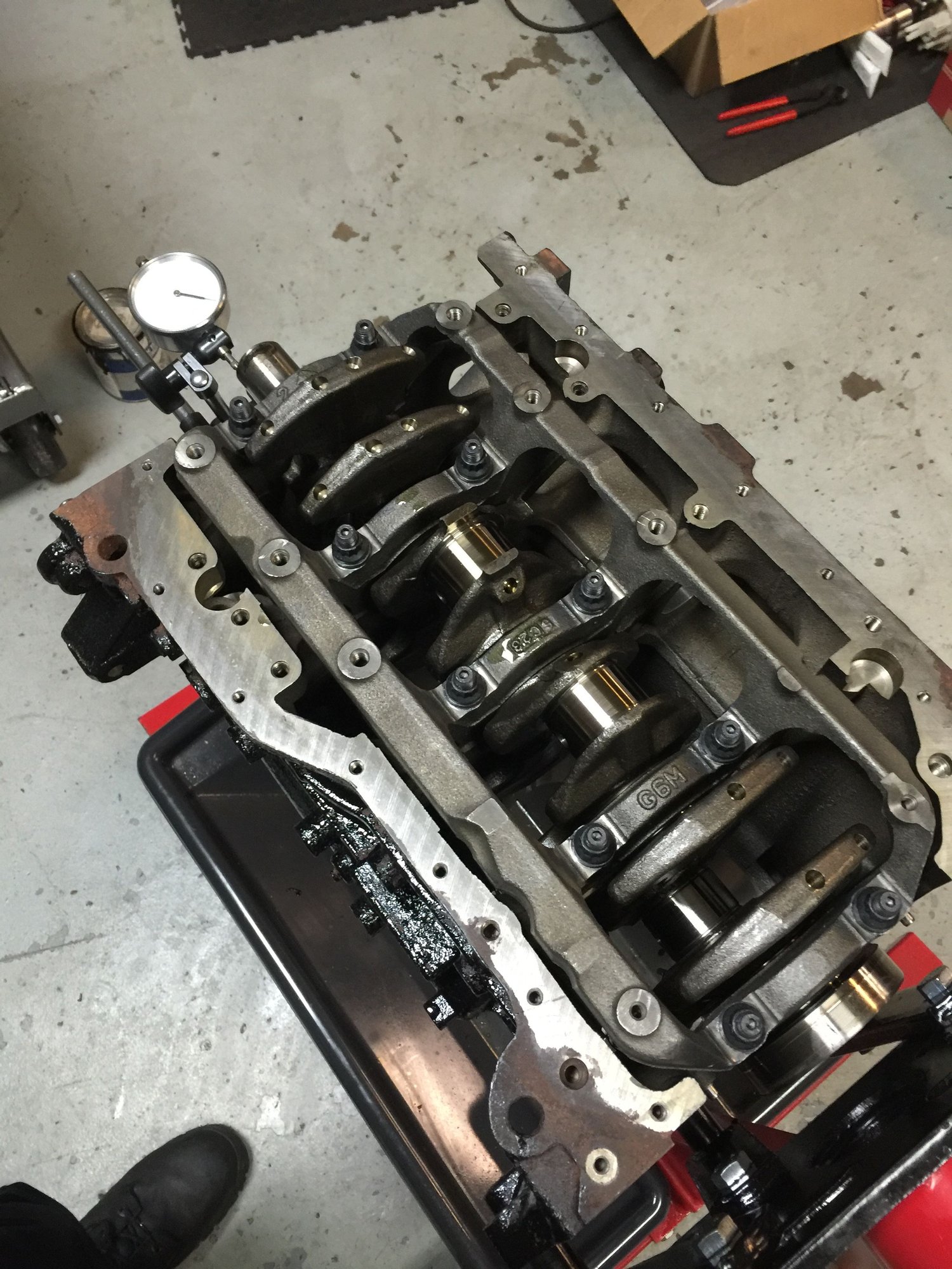

Here is a batch of polished cranks we just got back from the machine shop. I'll be sure to update this thread with some build pics!

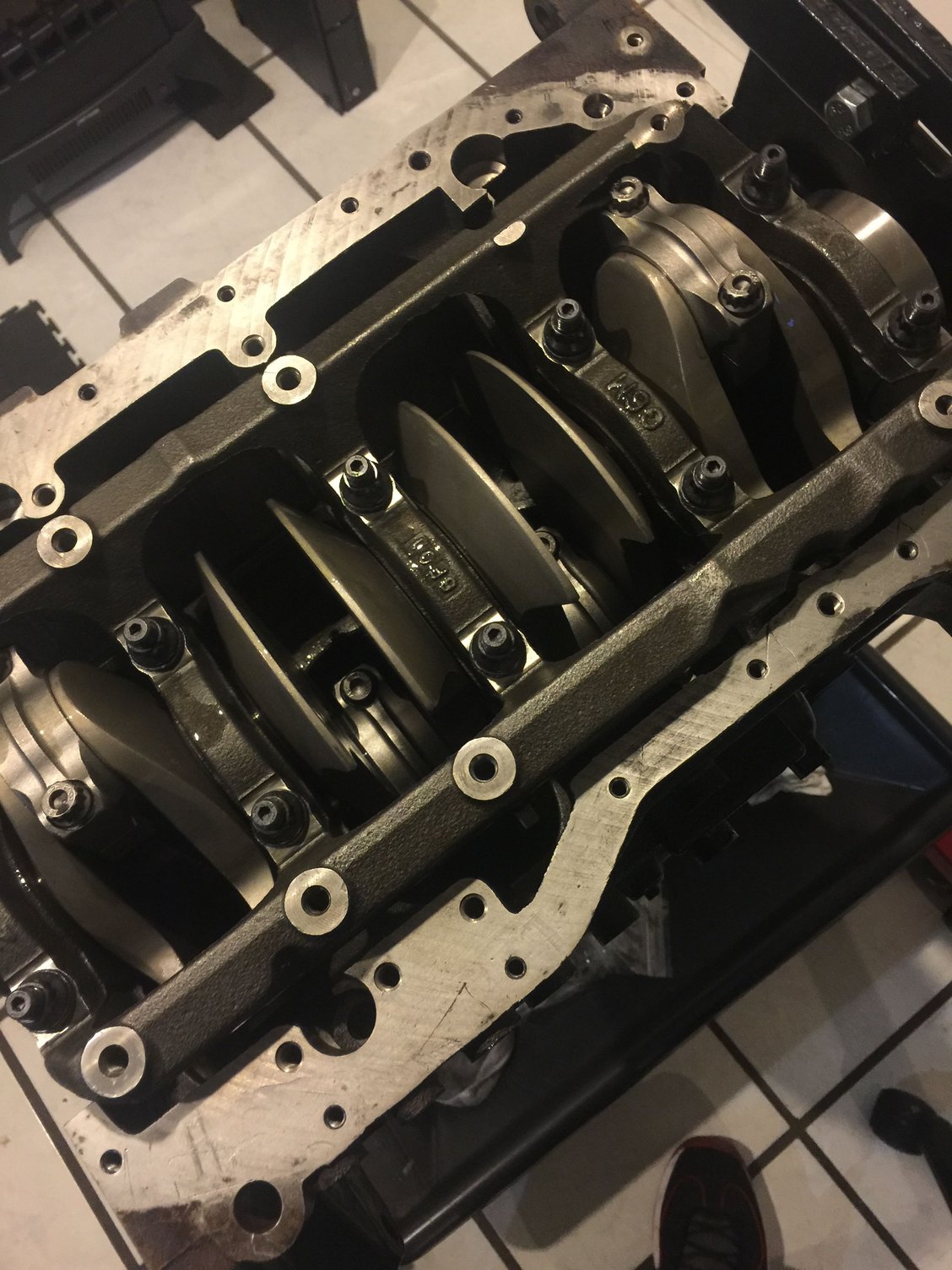

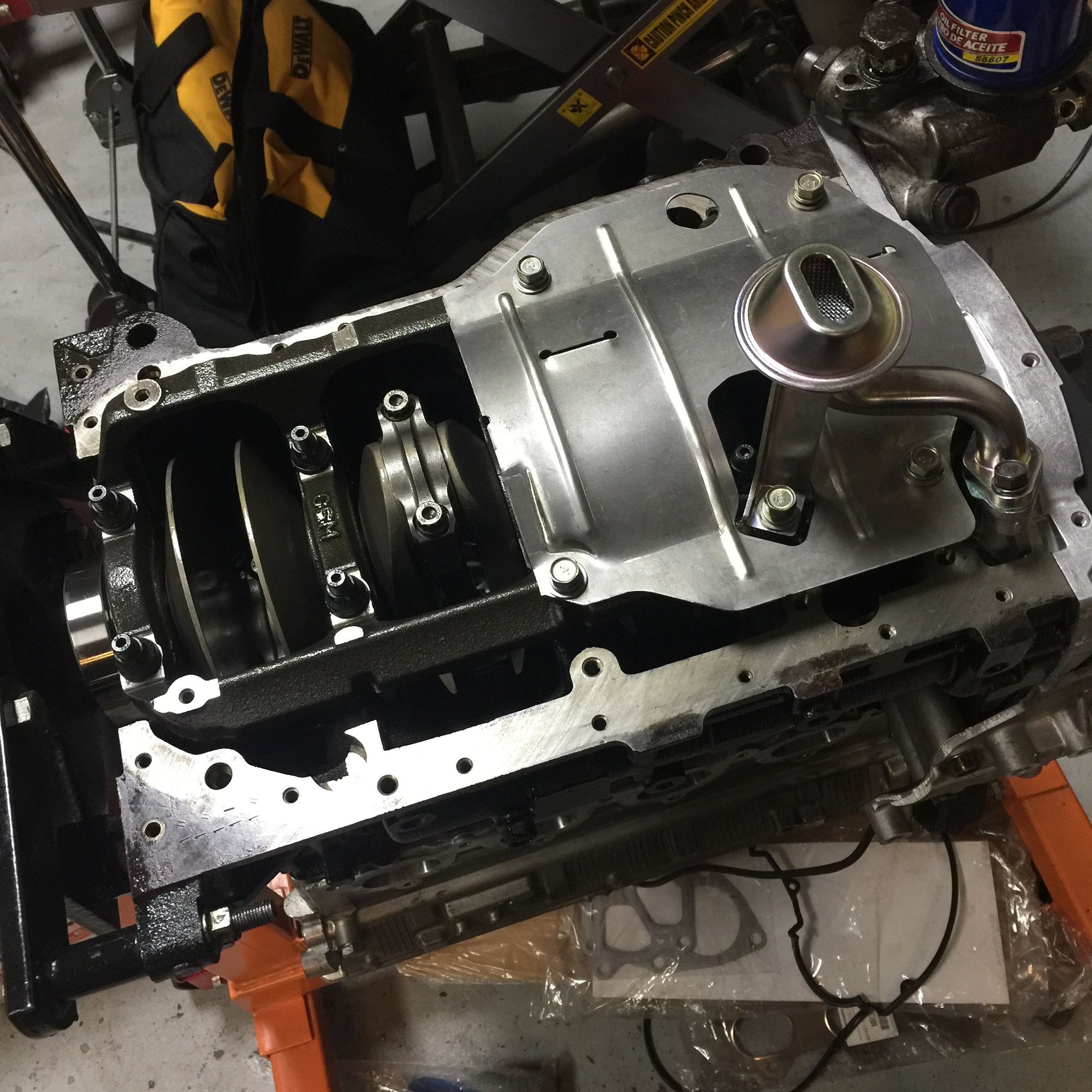

Few pics of some build stuff also on a Billet 2.3L we completed with our ported head.
