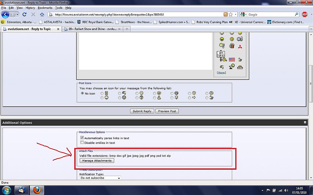

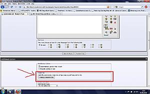

I cant figure out how to get the picture on here, but the place where you hook the throttle cable and the shaft have been ripped out

the other way to attach images to a post is via the 'Insert Image' button.
