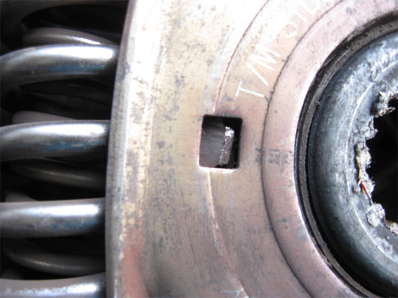

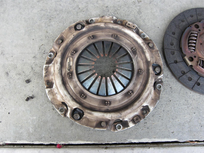

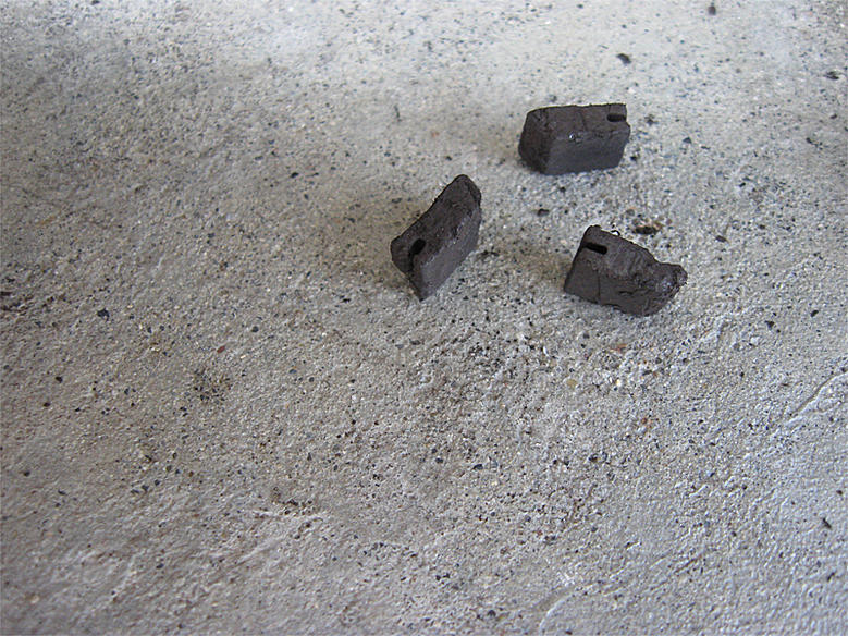

anyways, when I pulled the clutch out at first, everything looked fine. I had no clue what was going on... all the springs were in place everything looked fine besides some hot spots on the pressure plate. and then I shook the pressure plate....
A small black piece fell out. At first I thought it was a clump of clutch dust, but it was pretty hard and had a specific shape to it.
I shook the pressure plate more and 2 more pieces came out for a total of 3, all looking exactly the same. I looked at the pressure plate and tried to find where they broke off from.
I then looked at the clutch disc, everything looked fine, until I looked at the spring hub, and compared it to one of my old clutches.
Pressure Plate
Clutch Disc
Three black pieces that fell out of the pressure plate
Hot spots on the pressure plate
This is where the pieces came from
If you notice, there are only 3 pieces, but 4 spots. I assume the last one got wedged somewhere and worn down, or is still jammed somewhere

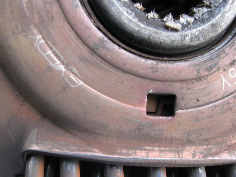

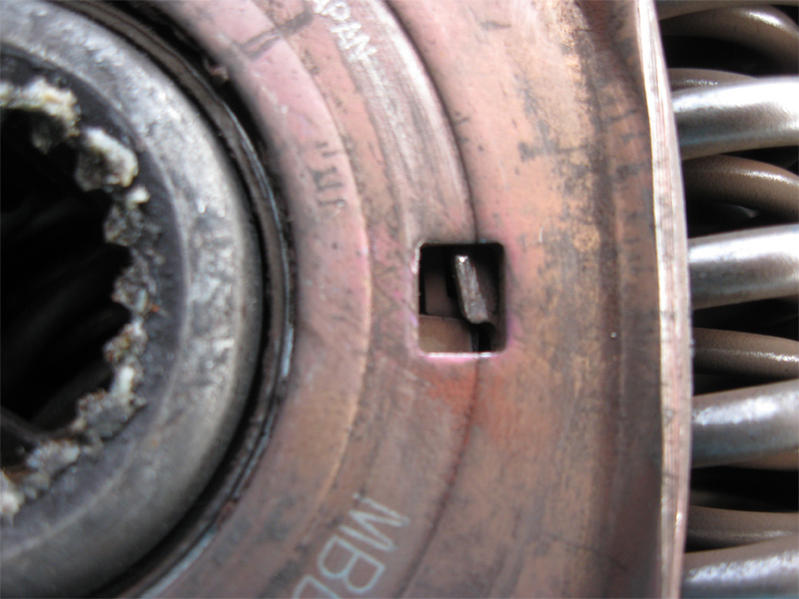

Compare it to one of my old clutches, all 4 are still in place:
and now pictures of each of the slots:
If you notice, things within the hub are no longer lining up. So I guess I was right that something broke loose in the clutch and was wedging things up. I guess those 4 loose peices wedged themselves in the pressure plate so I couldn't disengage it all the way.

well i would say that if your slave cylinder was pushing against those little bricks instead of PP springs, that would likely cause it, or the master to fail at some point, prematurely...
