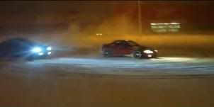

Notice anything about how this talon is driving parallel by this honda? Which one has HID bulbs in stock halogen housings I wonder? Oh yes.. the talon's "properly aimed" HID lights are beaming at the camera, the honda's halogens are not, both facing the same direction away from the camera. A motorist's iris' are more sensitive then the camera's iris, the camera is only picking up what it can see and regulate to record, but trust me there's way more of those excess beam patterns then what a human eye or a camera can see, and it hurts.. some more then others. It's like looking at the stars, you can see a star somewhere in your peripheral vision, but when you look there that star disappears, its the same idea, it's hidden light. Here is another example picture of this "aimed" kit:

Would the del sol's head lamps look just like this at the same angle? The answer is a definite no. Why? Because the honda has the correct bulbs in the correct housings that are designed for one another, the beam pattern is going to spread towards more where it has to and less of where it doesn't. The camera may catch a little bit of glare but it's not enough to compare to that awesomely blue brightness..
