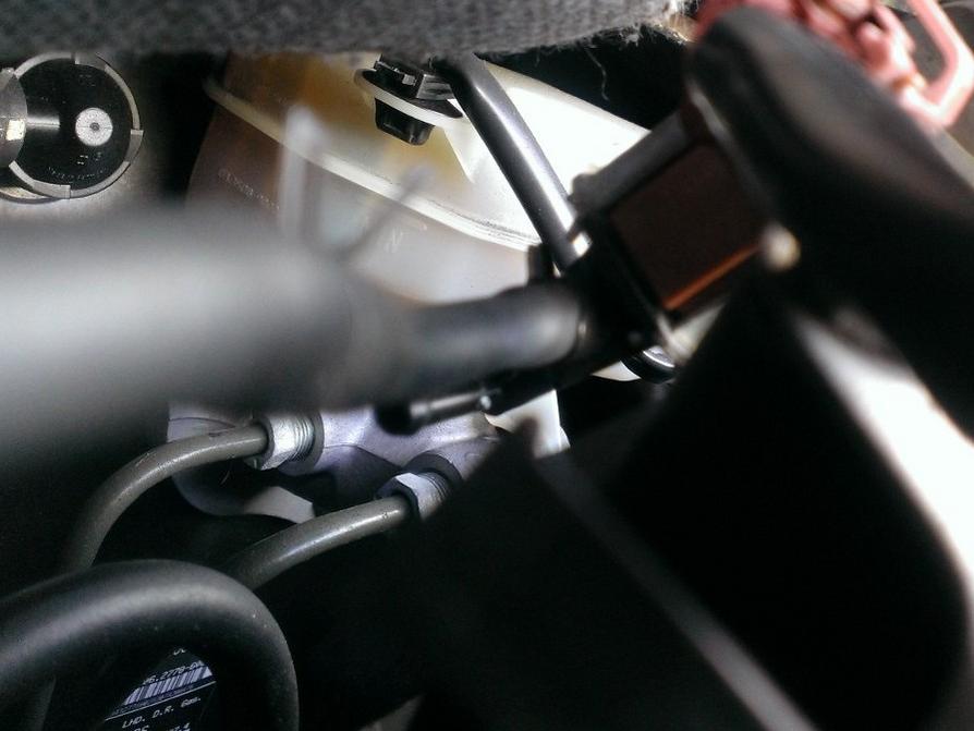

Hey there guys. New to the forums. I searched for hrs to see if anyone came across this problem before. I have a few Hoses that are M.I.A. and i have no idea where this connects to. One that's more noticeable is this one. Can anyone tell me where this connects to please? Help would be greatly appreciated.

The missing hose is this one, it goes right into the intake tube.
The other one you have should be going here:

Originally Posted by neogeo64
Checked my Setup (mostly stock)
yoU sir are a genius. lol i grabbed that part so many times and did not notice that slot. Any chance you know what type of tube and piece goes there? I bought this car not to long ago and noticed that whole tube is missing. Thanks in advanced!

Not to sure on the size, I think 5/32 vacuum hose at most autopart stores (you should be able to buy a foot or 2 of it and cut it to length.
It looks like your car was modded by previous owner. It probably had a different intake setup that did not have the return line opening from the boost solenoid (orange brown piece both lines are coming off of).
I connected the hose back to the intake to the boost solenoid. Another quick question. On the other line there is something clamped inside the hose. Im assuming thats the boost pill? I thought it was located in the hose closest to the turbo. Correct me if im wrong. Im still learning more and more about this car. 1st time ralliart owner lol
