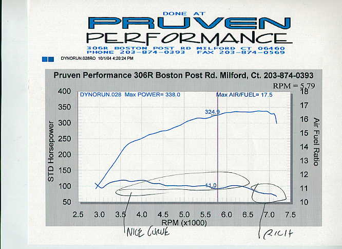

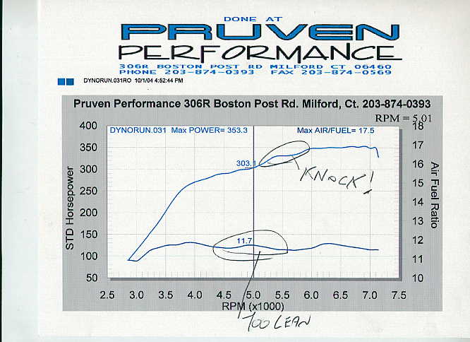

Here is his base line pull from Friday's session. He had added the valve train and apparently that really helped out the low end trq and leaned out the low end a lot. I have seen this same situation with Robi's car when i tuned for the Buschur Stage 3 head
We will need to take away timing and add more fuel
NOTE * This customer uses 100 octane pump gas on a regular basis

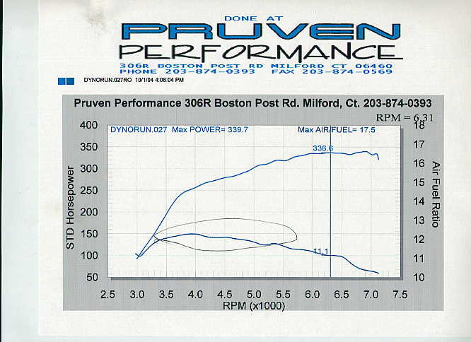

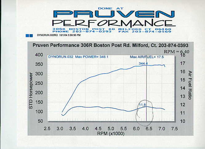

turning down the boost a bit for tuning safety - taking away timing and richening things up we find a nice safe starting point. Now we can begin to push the power back and listen and see how the engine reacts.

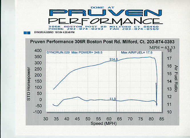

Things begin to take shape - but again too lean on the spool up - it needs lots of fuel in that area. The larger valves really aide the air flow in that part of the power band where the stock turbo is really strong

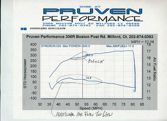

Now we have the VE table really starting to be dialed in on this new set up and things will work much faster from here
First step is take care of that little dip on the top end, lean out the whole power band a half point as this customer is on 100 octane and add some timing in certain areas

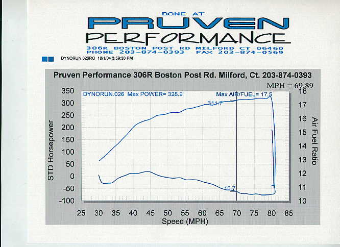

Of course - here we have reached a great curve and this would prob be good enough for some. BUT - I know there is more power to be found. There is also a little bump you could prob never feel right where I have the cursor. You can see the ecu pulling timing and then adding fuel at that spot. I need to step up the rest of the power band while adding more saftey margin in that area.

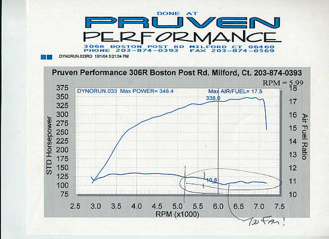

We are staring to make some serious power and I am liking the power band from 6000 - 7100 - flat.
The area from 5,000 - 6,000 is giving us some trouble however. More ign timing corrections are needed and the a/f tables need further adjustment.
