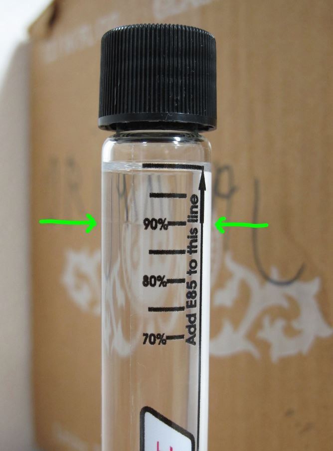

So I repeated the test 2 more times with the same result. Not complaining
I'm gonna store a cup of this ethanol and check again in a year. This is interesting. Does anyone have an explanation for this?

Here's a test of a 3yr old sample of E85 I have in a container jug in my garage. The same gas is still in my Evo, which I fired up after letting it sit for a while. It sputtered on a lean condition for about 5 minutes before the air/fuel ratio stabilized back to stoichiometric ratio of 14.7. I figured the fuel in the lines got bad, but not the tank.
