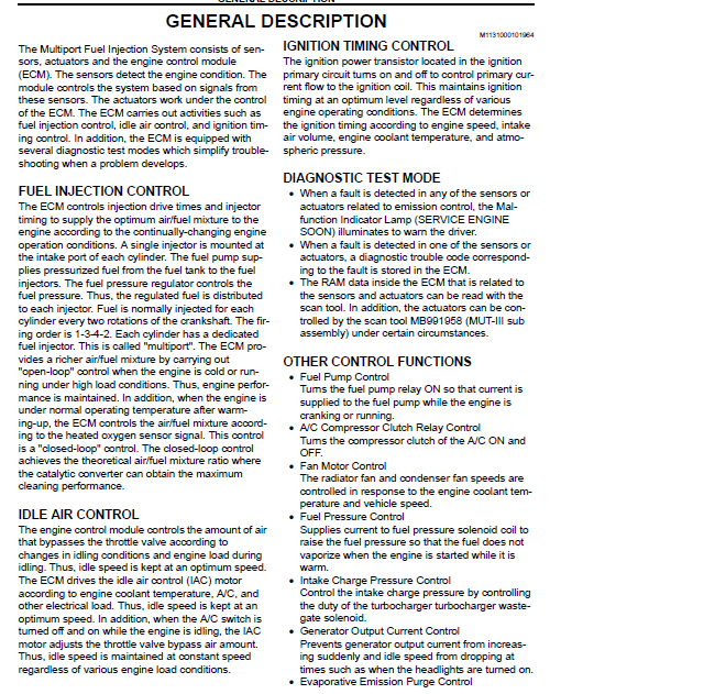

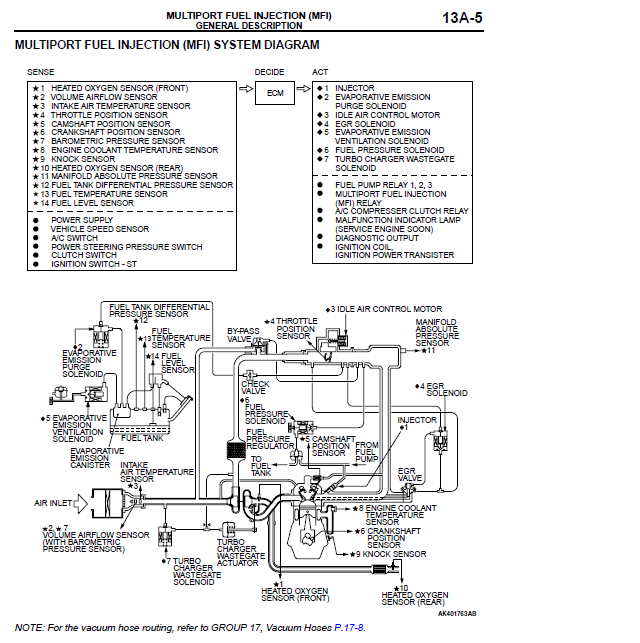

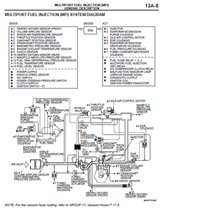

I got these out of the manual. These 2 pages have helped me understand some of the "why's" and created a lot more questions of how did they do it .
Attached Thumbnails How To Tune an Evo-evo-system-diagram.png   How To Tune an Evo-ecm-controls.png
