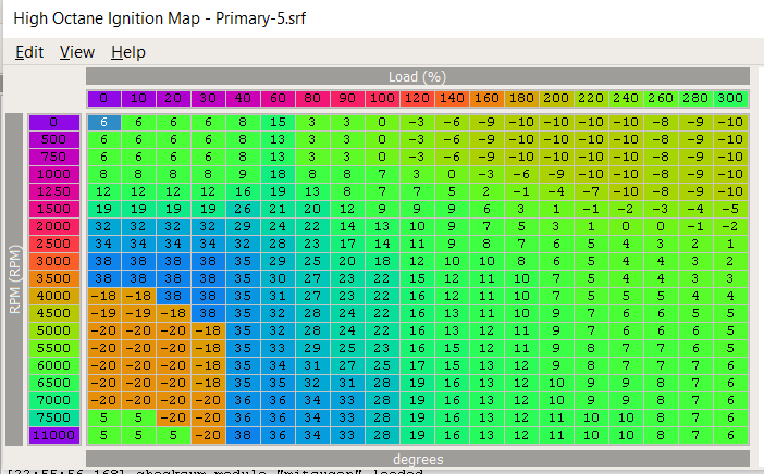

Originally Posted by I<3myevo6
Are you sure the log is right? I don't think you can hit 300 load cells with a Evo 9 turbo at 25 PSI. I feel your loosing a lot of power in the mid range especially post 200 load cells in the boost range.
I run a 25G turbo at 26PSI and the load cell I hit is 260~ and AFRs are at 11~ at WOT and 12~ at spool.
Ill take some more logs when I get my evo back, should I try upping my timing and lean out my afr in the mid-range area?
+2 to +3 deg at this load and RPM is very safe for an Evo 8 with stock compression, Kelford 272s and 25 psi boost.
From 200 to what load range would you recommend I add timing?

From 200 to 250 in the RPM range 3k to 6k start with a 4 degree increase and taper to 1-2 degree at 6k. I am sure your car will not knock much as long as you ensure AFRs are under 11.5.. Run a log and let us know.. If need me I can look an my old map that I ran fast and clean on a evo 9 turbo with stock cams.
What is the ambient temperature at your location?
Hey, I'm stationed in San Antonio Texas, so it's hot(70-100s degrees) pretty much 8 months out of the year. If you can upload the map you were talking about so I can get a better idea of how it should look, id really appreciate that.

@Tomkun This ignition map is for an Evo 8 2.0L with 9:1 compression and 25 psi boost flat across the rev range, Kelford 272s and 91 gas. The safe operating ambient temp range is 70-100 deg F.
If you are running 93 gas you should be able to add a further 1 - 2 degrees timing without knock, but you must check!
Hey, so I tried your ignition map with +2 on all the cells after 100 and it felt a lot smoother/stronger. I did encounter a knocksum of 6 at one point so I’m going to try lowering the cells back down 1. Thank you again.

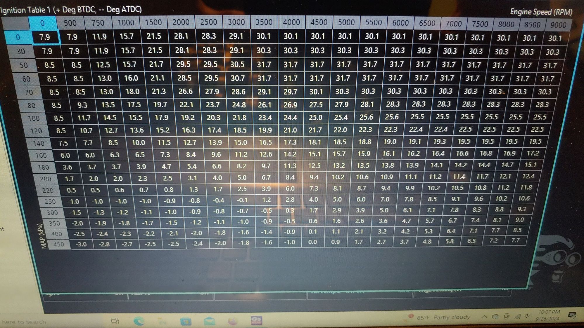

Hey everyone, I want to start by saying I am not a tuner but engine builder but I do tune my personal, friends and family cars. Here is my timing map. It is evo 8 2.0L build engine 10.5 compression running 6466 next gen turbo and e85 fuel (e75 currently from pump) At this moment running around 35psi boost but I will eventually run 45-47psi but before I crank the boost that high I have a question. On my current 35psi boost my peak is around 5600-5700rpm and around 3.5 degrees timing and around 8.0 degrees at 8,500rpm.. Am I too conservative with this timing? I know every car is different and best way is to put the car on dyno but currently only street tuning is available. Car is running amazing but I am wondering if I am too conservative? Thanks!!

10.5:1 ouch. Not alot of wiggle room with timing and that compression. I would stick it on a dyno and keep it on the soft side so the head gasket lives.
I know, that's why I am playing safe. My last motor was also 10.5:1 compression and was running on similar timing for 6 years, then I started to be hungry for power and finally lifted head on 6466 at 44psi boost 7 degrees on peak and 14 degreest at 8500rpms hehehe. Now I am playing safe. Car runs excellent on this timing that I posted but I am wondering how much I left on the table. I will take it on a dyno whenever I have a chance. Thanks!!
