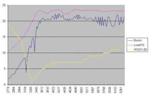

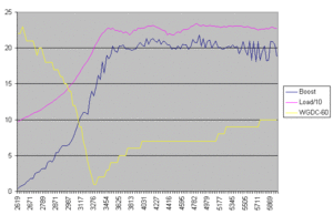

Here are a couple of most recent data.
ECU+ is used to log everything. MAP sensor is GM 3-bar. Load is 2-byte.
You can see from about 4000-5000 there is a fluctuation in boost even though the WGDC is constant (boost error correction is off).
So is it due to my 16G-9.8T or the stock turbo outlet? Or something totally different (like the cat)?
Mods: downpipe, 200 cell cat, cat-back
Attached Thumbnails Comparison graph of boost before and after O2 and Manifold install (91 octane)-boost_wgdc_01.gif   Comparison graph of boost before and after O2 and Manifold install (91 octane)-boost_wgdc_02.gif

Bump up the WGDC a little bit in that section. Remember you can rescale the RPM in the WGDC table so you can give yourself a little more resolution in sections like those.
I have an '03 VIII with 3" exhaust, no cat, HKS 272s, and 10.5 hotside. I still see the dip right around 4500. As far as I can see, it's just a characteristic of the engine.

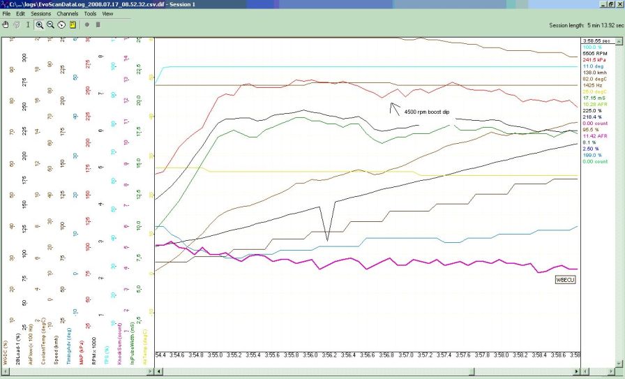

boost dip
on my 2004 edm evo VIII - 3" turboback and free-flow cone filter - I see the same dip in the boost- do not know how to cure it (WGDC is 100% over there all the time)
Attached Thumbnails Comparison graph of boost before and after O2 and Manifold install (91 octane)-log.jpg
Old Jul 17, 2008 | 07:57 AM
  #84
roger smith's Avatar
Posts: 357
From: Ventura County, CA
I will try and post results. Thanks for the input.
Thinking of the dynamics of everything I can't explain why the WGDC curve would have to bump up like that. In theory if you left WGDC at a certain number through the whole RPM band then boost/load should hit some peak and fall off.
Does your car do this, Bryan? Or maybe it's just with 03s?
