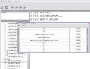

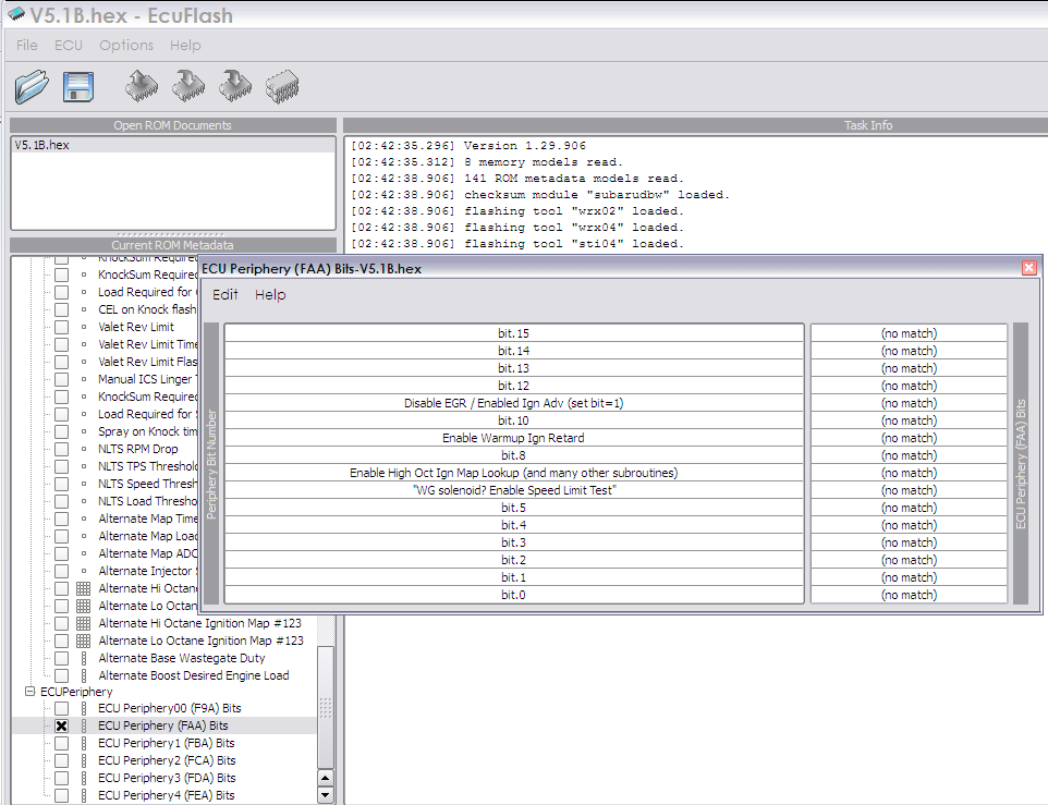

But I got this:
What in the world does that mean?

But I got this:

Hey, I got it to show the right values by adding the first couple lines as earlier discussed.
My problem now is that I am throwing a P0500 code for the speed sensor and want to disable it. I tried changing the value in periphery 3, bit 6 from 1 to 0, but the code still shows up?

No changes need to maintain compatibility with newer versions of ECUFlash. Just pull your custom XML files out onto your desktop, install ECUFlash 1.3x, and then drop your custom xml files back into the appropriate folder (replacing the existing ones). Just keep in mind that some people are having issues with their cable not working with v1.3x. If your cable doesn't work with 1.3x, then if you bought the cable from Tactrix or Mynes, call Tactrix to sort it out. If you bought it from Limitless (EvoScan), then contact evo4mad to get a fix.
