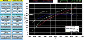

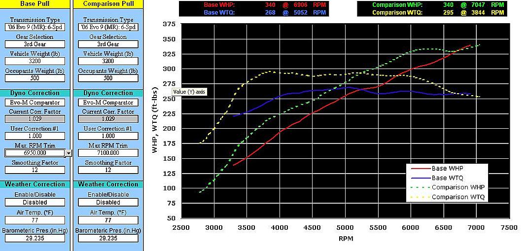

I lowered it 100rpm and it still is pulling, i think itis legit.
Here is a comparison from an earlier log. The whole time he was running my tuned MIVEC map. I did add a touch of MIVEC to redline and it did change the HP up top. I will try to find that log as well.

To be certain go as much as 250rpm but you should never need to go more than that to correct the math error. Thats great if its legit though
