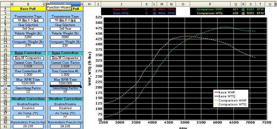

How do i choose a smoothing factor? the base pull is on 12 an the comparison is on 10 but why arnt they the same?

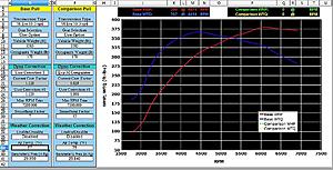

Here are my results.
FP Red + FP-4R cams + E85
Run #1 =85 degrees ambient
Run #2 = 110 degrees ambient!!! I added a degree or two of timing up top.

nice job. How much boost?

30psi and 414 peak load. Stock o2 housing too.

Click on the DIRECTIONS tab at the bottom and follow the link for a description of just about everything. The larger the file size, the more smoothing needs to be applied to average out all of the data.

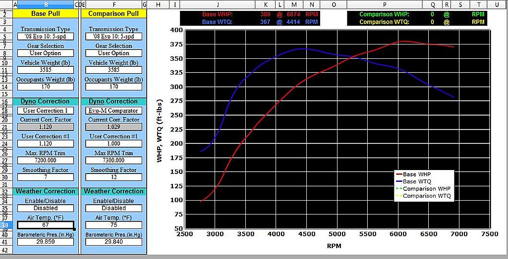

Here are my numbers according to the user correction that Melon used to make his numbers close.
2008 Evo X GSR. Run was done in 3rd gear.
380whp @ 6074
367wtq @ 4414
I hope these numbers are close to what the car really has. lol I'm going to do a dyno tune sometime in november. I'll report back then.

Jack said the base pull section was flawed, go back in and paste all your info into the comparison pull section.

The Evo X's aren't going to be 'EXACT' yet until we can get the Drag Coefficient and Frontal Area for the X added to the simulator.

I just did and got the same exact numbers.
380whp @ 6074
367wtq @ 4414
This is in user option utilizing a correction factor of 1.12.
In Evo-M mode:
350whp @ 6074
337wtq @ 4414
