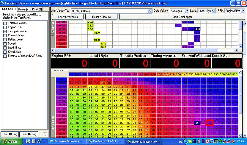

I have a strange trouble on my Evo VII.
I`m using Tephra v7 and EvoScan 2.9.

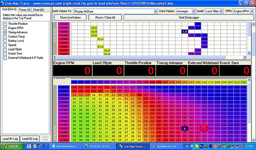

I`m logging the 1byteLoad and then, when i look to my log, i see that the values in log cells doesn`t match the map. They are the same that in 2 or 3 columns higher (by load).
For example: at 250 load and 3500 RPM i see ignition -3, but in HighIgnition Map of my ROM placed the 2 value. And -3 value placed in third column right (280 load). And so on...
This mistake takes the place at WOT and at Cruise.
Attached the screenshots of MapTracer.
I tried to test my stock ROM and there situation is the same. (last screenshot).
Has anybody any ideas? I don`t know, what to do...

Attached Thumbnails Help! ECU reads the value from another column-1.bmp   Help! ECU reads the value from another column-2.bmp   Help! ECU reads the value from another column-3.bmp   Help! ECU reads the value from another column-4stockrom.bmp
