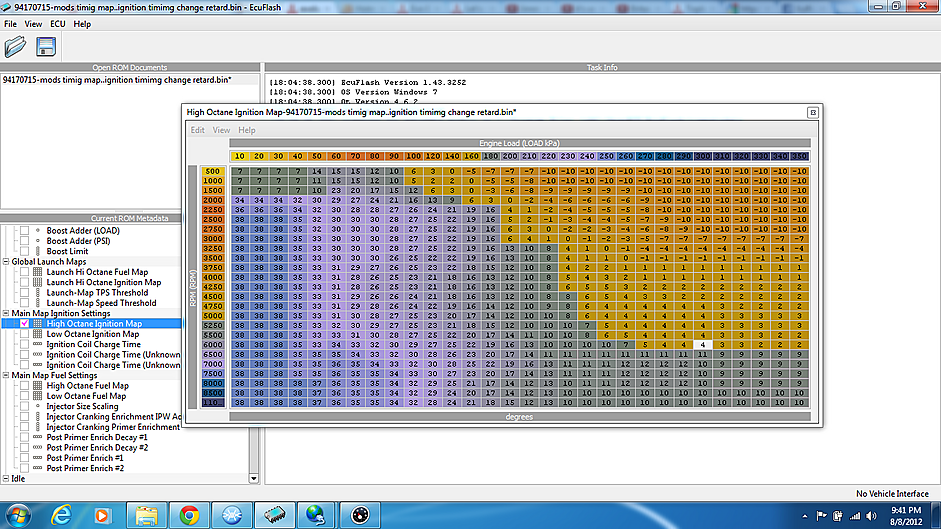

hi my gt3586r shows peak torque at 6000-6300 rpm, what should be my timing there?

We can give you an idea but every car is different. Put up a mod list and the fuel you are using. What are you currently running timing wise?

yea here's my mod list:
gt3586
gsc s2 cams
FIC 1250cc injectors
1.8 bar boost
93 octane fuel
and right now my timing map looks like this...btw in virtual dyno it says im hitting peak torque at 6000-6300 rpm, but dont know what timing i should be running,look at my map and see if its okay or i need to bump up or decrease timing?

I need to know what loads you are hitting, post up map tracer or a log. But I would smooth that map out big time. Stock or built motor?

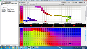

im hitting loads of 300+
heres a map tracer..and oh its a stock motor.
Old Aug 8, 2012 | 10:29 AM
boosted91t's Avatar
iTrader: (65)
Joined: Oct 2007
Posts: 723
From: New Oxford, Pa
You can run more timing up to peak torque. I'd say 4 deg is resonable on stock motor, might be able to pull off 5 deg. But again you will have to just play with it. Definately work on that 6,000 rpm on out, its super blocky.

The reason your torque peak is like that is the 7* jump you have going on in the first map you listed.

Try running 10 deg out the top. Taper the 4 deg from 5500 to 10 deg at 8000
hi can you explain it to me where im having a 7* jump?
and should a car with my mods be hitting peak torque at 6000rpm or sooner?
so i should get rid of the 11's and 12's at 6500 to 8000 rpm and run 10* instead?
and by tapering it down you mean 4,7 and then bring it down to 10?

Interpolate vertically from your 4 degree at peak torque to 10 deg at your max rpm.
Between 6000 and 6500 rpm there are 7 degree jumps.
