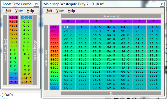

i'll tale a look at it! if you want i can upload my xml for you to compare. be aware mine is an SD 2.0 though. 94172715 . BUT it inherits 94170715.
only issues i'm having are with boost error correction. it's running great don't get me wrong, and not over boosting. but my boost error when i log is all over the place. i think i used mrfred's boost error table AFTER dialing in my main map wastegate duty cycle table. maybe my BEC values need to be lowered? my values are below. any input? or recommendations? i can upload other tables and xml as i have mentioned if anyone wants.
