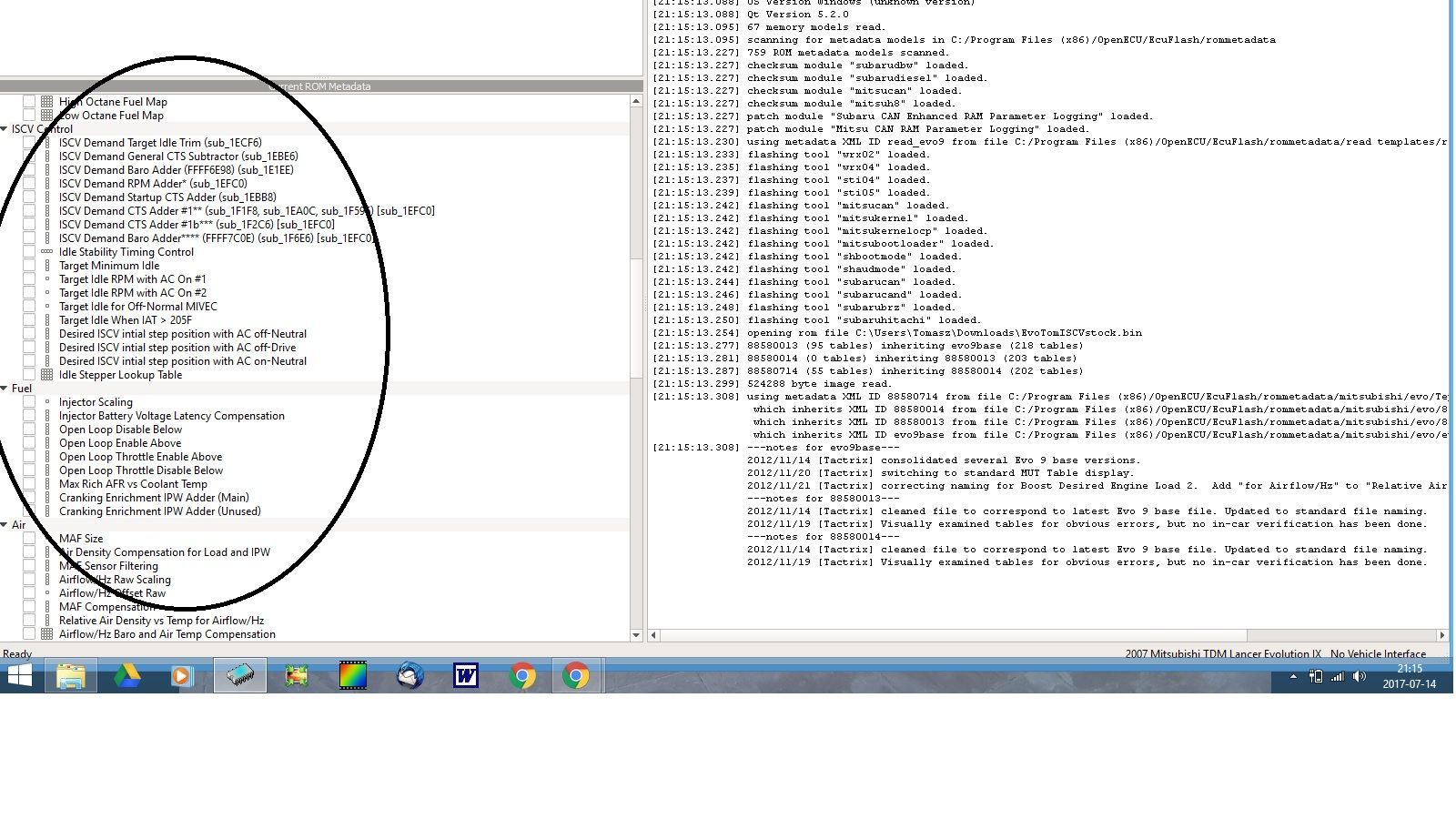

Hello guys. I have rev-hang problem in my EDM Evo 9 07' with 88580714 v7 rom.
I'm not sure which tables should I touch to eliminate it. Except rev hang, sometimes when I stop the car (i.e. at red light), idles are raisning up to 1800 - 2000 rpm or "waving".

Read this post from beginning, there are some tables to add and lots of helpful things. Also links to other ideas about it.

Ok, I think I'm good thanks to this thread
https://www.evolutionm.net/forums/ec...8586714-a.html

Ofcourse i've read it, few times, but there's no definitions for my rom number.
