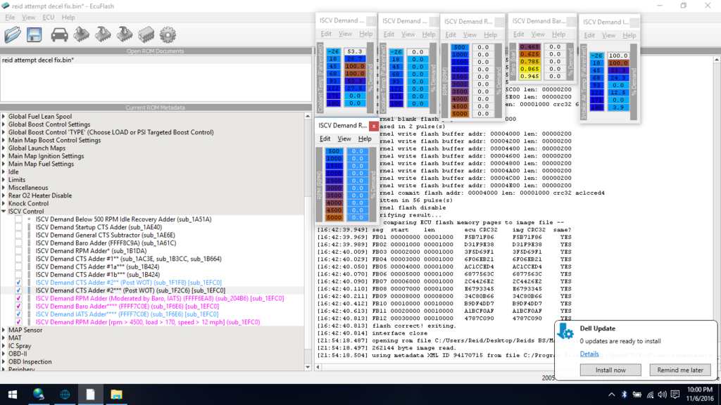

Zero out these two tables:
1. ISCV Demand RPM Adder [rpm > 4500, load > 170, speed > 12 mph] (sub_1EFC0)
2. ISCV Demand RPM Adder (Moderated by Baro, IATS) (FFFF6EA8) (sub_204B6) [sub_1EFC0]
cdrinkh2o is offline
Reply With Quote
Old Nov 6, 2016, 10:06 PM
Join Date: Mar 2010
Location: Reno Nv
Posts: 313
Thanks: 0
Thanked 3 Times in 2 Posts
Ok i will try it. I also zerod out some of table i thought relevant. Screenshot below. But I will try the process of elimination to figure out whats the exact issue.
