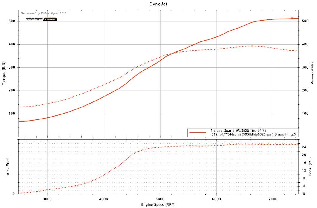

I have been tuning Terry now for many years. Recently we retuned the car. The cars located in Germany and is on 93 octane fuel.
Mods on the car are:
Stock block /w over 142K+
FP Black BB Turbo (MHI Housing not SS) (/w SS housing I would estimate 540)
Buschur 4" Race Core FMIC
Buschur 65mm TB
STM Stock Replacement Exhaust Manifold
Buschur Ported Intake Manifold
Buschur Turboback Exhaust
MAP 02 Eliminator Downpipe
Buschur LICP / STM UICP
1000cc RCI Injectors
STM 3" To 6" Velocoty Stack Cold Air Intake
Tial Q BOV
Walbro 255 Fuel Pump
GSC S3 cams
GrimmSpeed 3 Port
ARP Head Studs
Tephra v7 Speed density /w ecuboost
Graph and picture of car below; (Any questions feel free to ask).
One more graph with afr captured & more weight in car:
