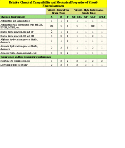

toluene = NO!
100% methanol = it really depends as there are several grades of viton......best bet is call shurflo and get it from the horses mouth

50/50 water to methy alcohol will be ok for the shurflo pump
that toluene/meoh/water sounds really workable........anyone has a suggestion on what kind of pump will pump this mixture?
fuel pump = not good for water
shurflo pump = not good for toluene.........
