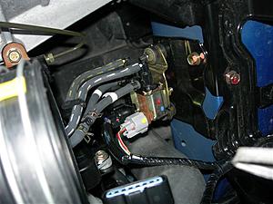

Hi guys, I know this is getting boring but!! I have a new Jap import E9 2006 had 30km so unmodified in Japan. (Car is now in NZ)
Mine most defiantly has to restrictor pills next to what appear to be two boost control solenoids (stacked one on top of the other)!!! There are two BCS and a hose from each that tee them together see pic hoses with the clamps. There is also a vent tube from each solenoid and a tee joining them before they feed back to the intake pipe. In the pics attached I have put white tape where the restrictors were. Question, did I do the right thing removing both these restrictors, as they are both in the same loop of hose. Car feels good without them, but mine has no boost gauge yet!! So I can’t see boost level.

hey Warrtalon, do you have any idea what the doubling up is about on mine, with what appears to be two bcs.
