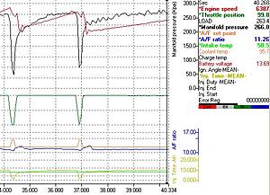

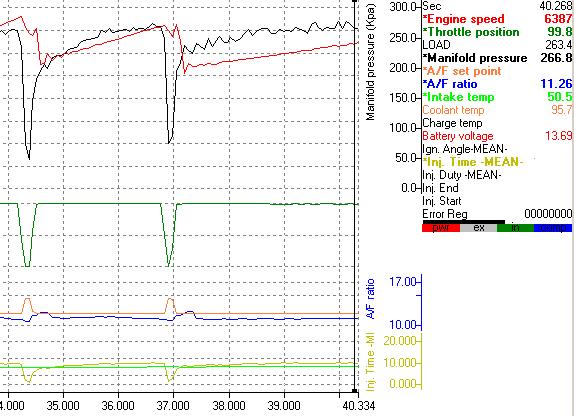

Ok I'll start
1. AMS Intercooler
2. 26c
3. 50c
4. AMS GT35R / intake manifold / 1.8 bar
Attached is data log with point in time selected near top of 4th gear.
So in my practical experience... I'm seeing about 25c degree over ambient.
