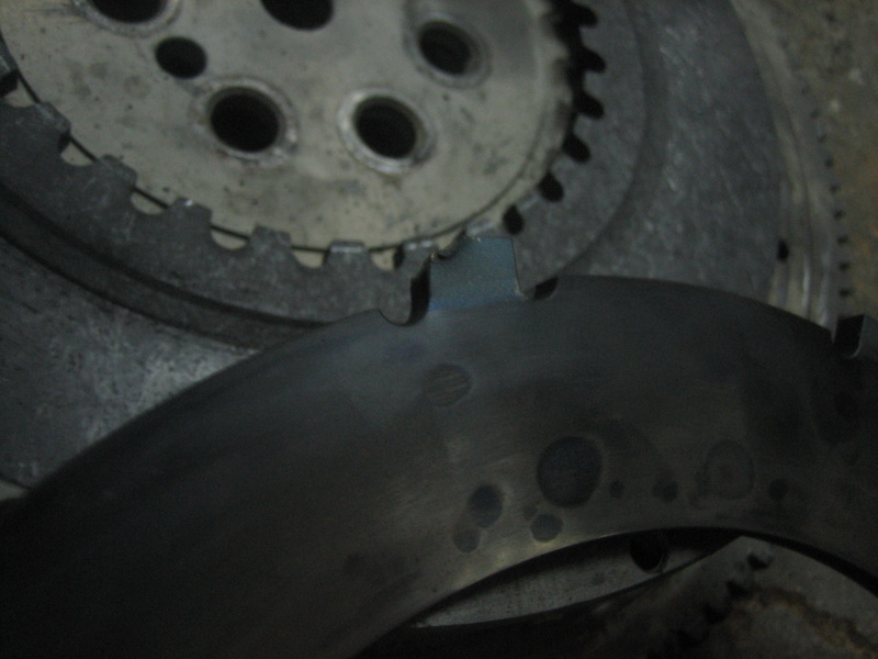

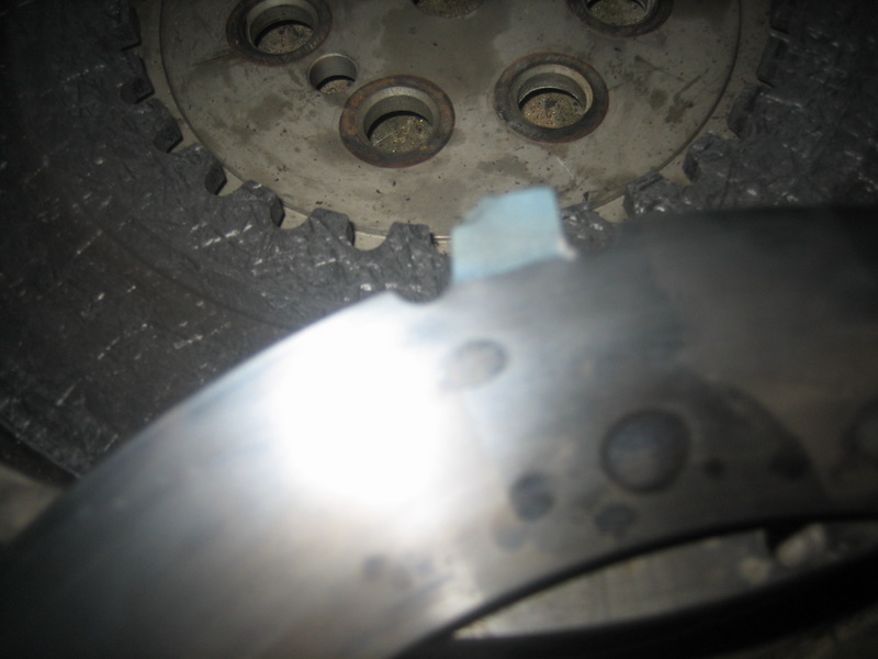

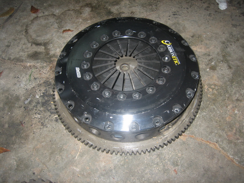

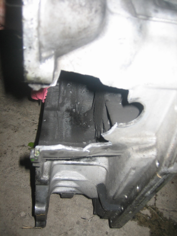

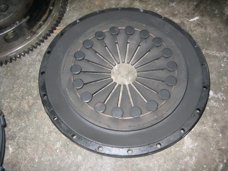

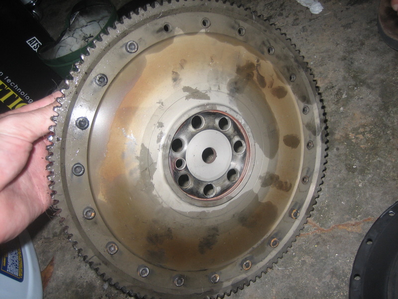

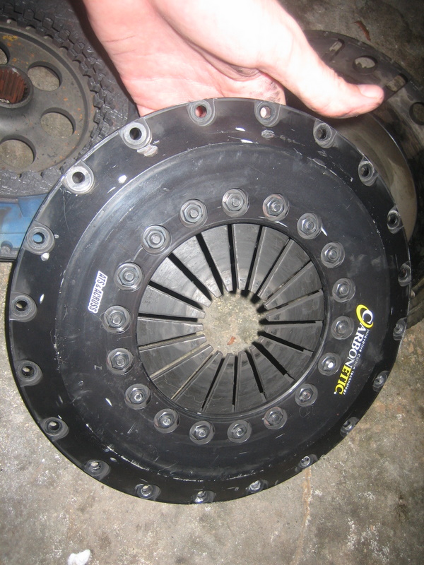

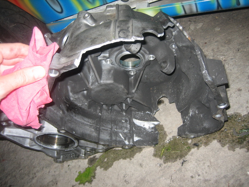

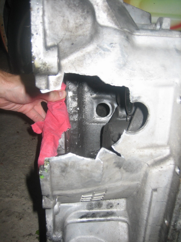

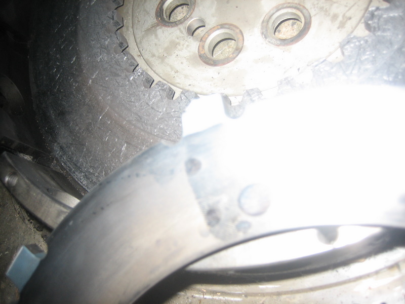

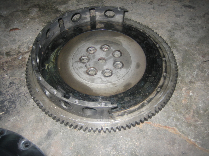

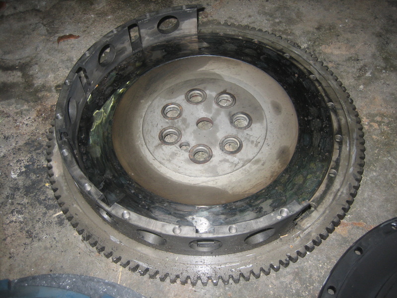

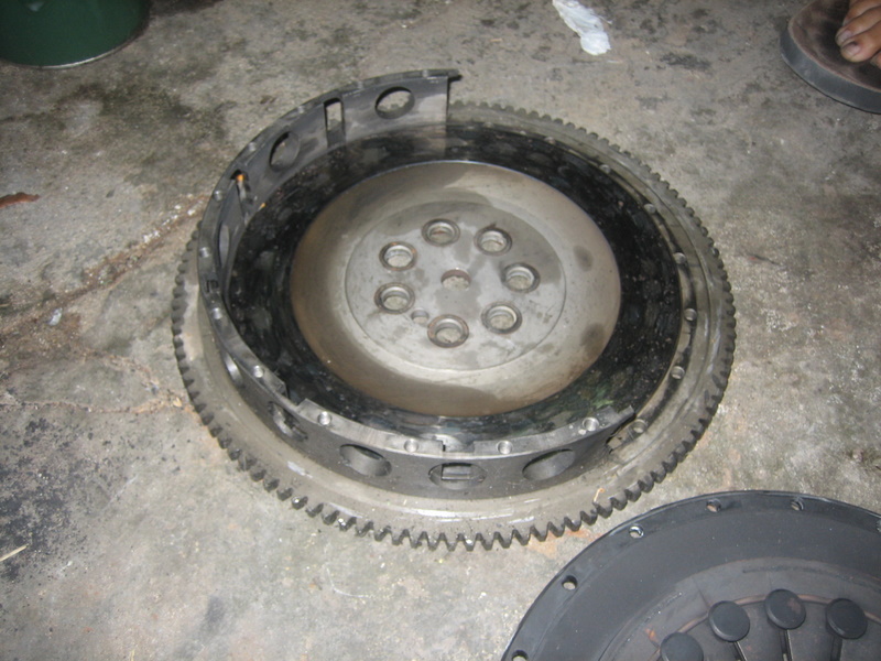

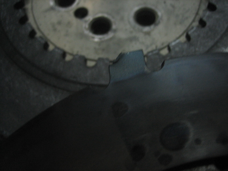

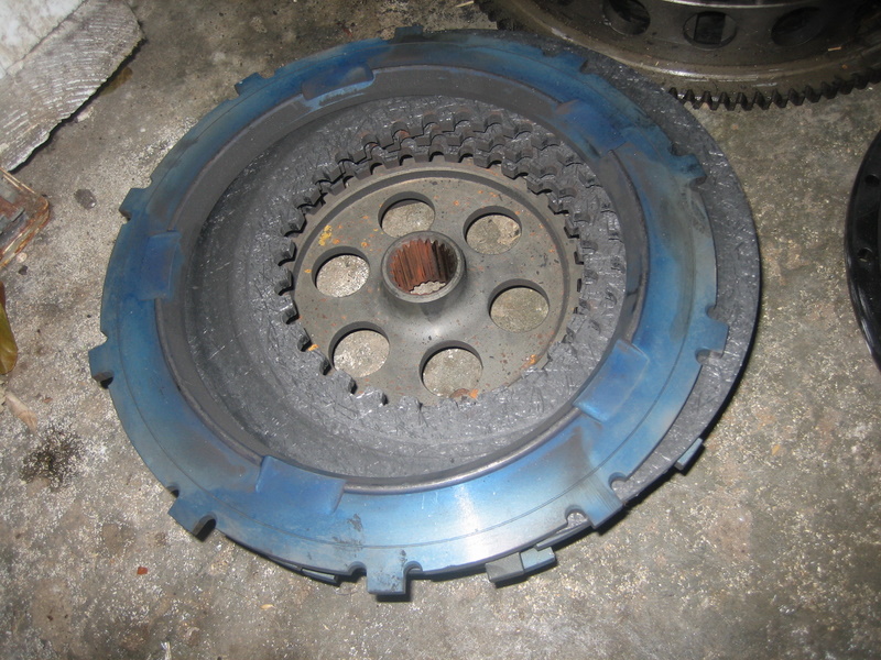

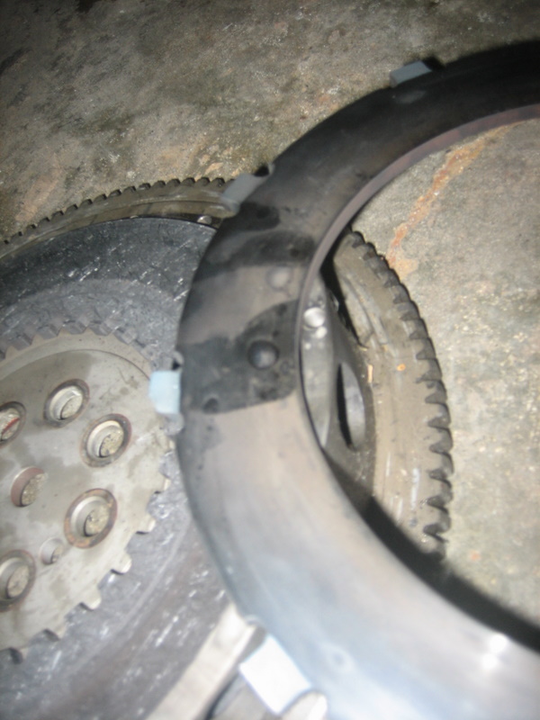

Ok I went over to friends house last night to check it out. I'm interested in all this because I have a brand new ATS triple sitting here at home that I bought for future use and am now worried about using it. For sure I won't use it without a scatter shield now.

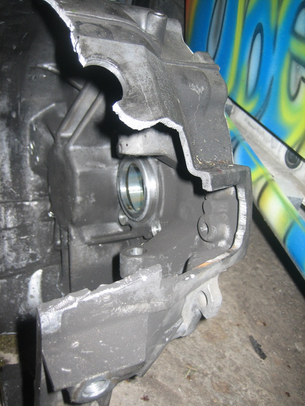

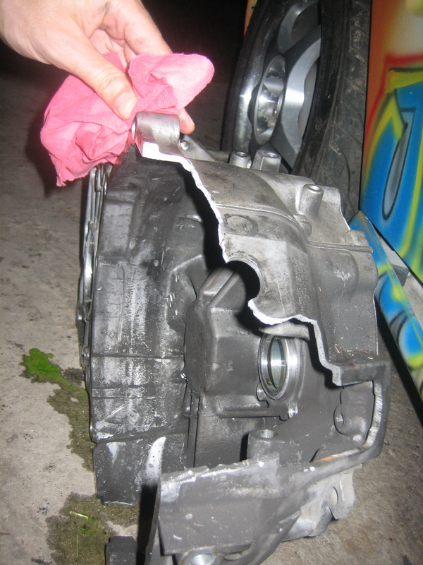

Here are the pics. I forgot to get some pics of the mashed up turbo. If you recall from my original post, a large piece of the bell housing tore through the silicone couple on the turbo intake and mashed up the compressor blades real good.
Pics below:

Were all the bolts still in the clutch? Could it be they come loose then when they fell out the basket exploded.
Mark

The bolts where tq down right its that simple. You have to go around a few time before installing. The few people a i know that have the clutch said they went over the bolts from 6-10 times top insure it was done right one guy has 8k miles countless passes no problem at all.

Since the flywheel and clutch hat are in place but the ring broke, It looks to me like the bolts came out or broke off. The remnants of the ring will tell the story. If all the bolts are broken off inside, the bolts failed. If there are at least a couple empty holes then the bolts came loose first so it is not the fault of the clutch.

FYI
I asked and they said definitely the bolts holding the basket to the flywheel sheared. I'd have taken a pic but I think the pieces of basket are off to ATS to have a looksy.

Another friend with Evo 9 has had his Carbonetics triple EXPLODE. I'll try to get some pics. This is a friend of mine with Full-Race twin scroll GT40 and 2.3 IX RS running Halltech. Apparently this time it has totallly destroyed the gearbox not just the bell housing!
