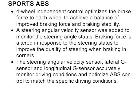

What is the g sensor for on the car? is it used by the braking system to determine if you're actually stopped or not?
Old Sep 20, 2003 | 05:51 PM
Dale_K's Avatar
Posts: 454
Here is something from the tech manual.
