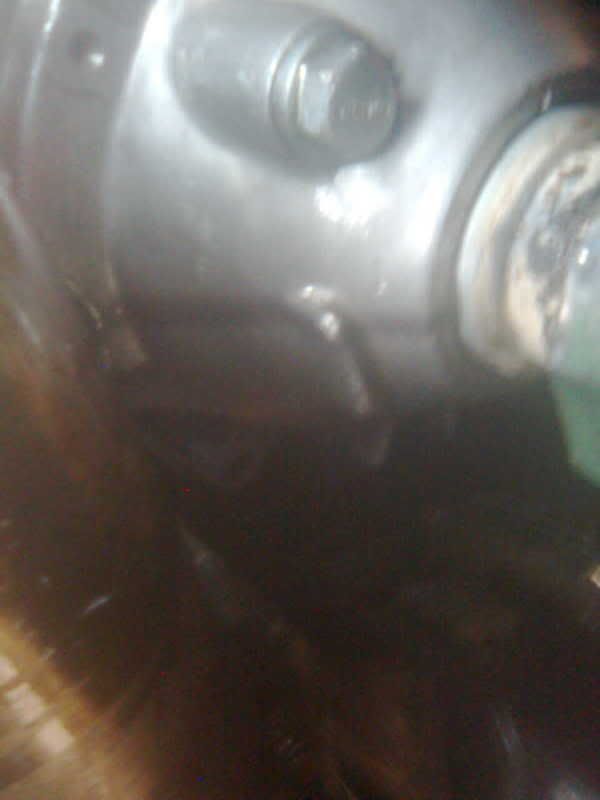

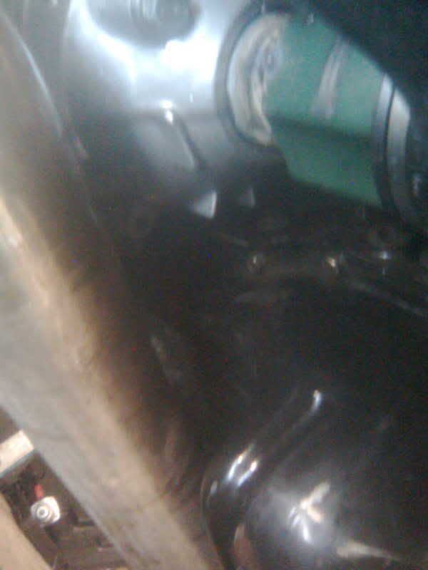

so i changed the outer seal! i thought for sure it would work!
nope still leaking i took a few pics of where it leaking right after i drove a few blocks.
yes you may wounder why i welded my cup cover that is on teh cvboot because it keeps sliding off so i spot weled it in place!
i dont know maybe i need to push the cup in to the t-case more mybe ! but it should'nt matter the rubber seal holds all fluids in the t-case.

Old Apr 3, 2009 | 08:04 PM
allday10sec's Avatar
Joined: Dec 2008
Posts: 129
From: sunny city
no it is thin and it was dented before i used it heres a picture

From: Grand Island, NE
Thanks for the picture but it is blurry. If you are meaning the green part that is the outer housing for the CV joint. I think I see a dent on the backside that looks like somebody applied too much force when trying to remove the axle. If it is not deformed on the inside it should be okay. Otherwise, replace it.
The axle seals are easy to damage when inserting the axle. Take special care not to allow the splines to touch the seal.
Old Apr 4, 2009 | 10:44 AM
Joined: Dec 2008
Posts: 129
From: sunny city
not the green thing! the cup inset that is in teh t-case !
any ways yeah
