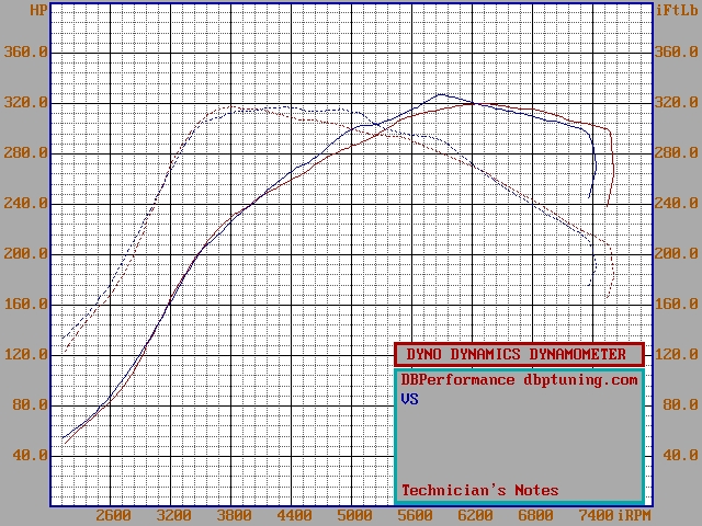

Originally Posted by S2kracka
Sounds like the FP4R camshafts are what you need.
Yup, those are the only thing I'd recommend, but even then it might not be worth the hassle. Here's an overlay of two local (MN) IX's, one has Cossie M2's (red) and the other has FP 4R's:
Boost is similar, most mods are similar, but the blue car has a ported IM/TB. These are from different days/weather conditions so it's not an ideal comparo, but both are final results from pump gas tunes @ DB Performance. The 4R's seem to hit a little harder during boost onset on the street when stepping on it or inbetween shifts; the dyno does not tell the entire tale.
When you say you want more midrange, what specifically do you mean? You could do alky injection or E85 and pick up a ton of midrange torque...enough to make you giggle
