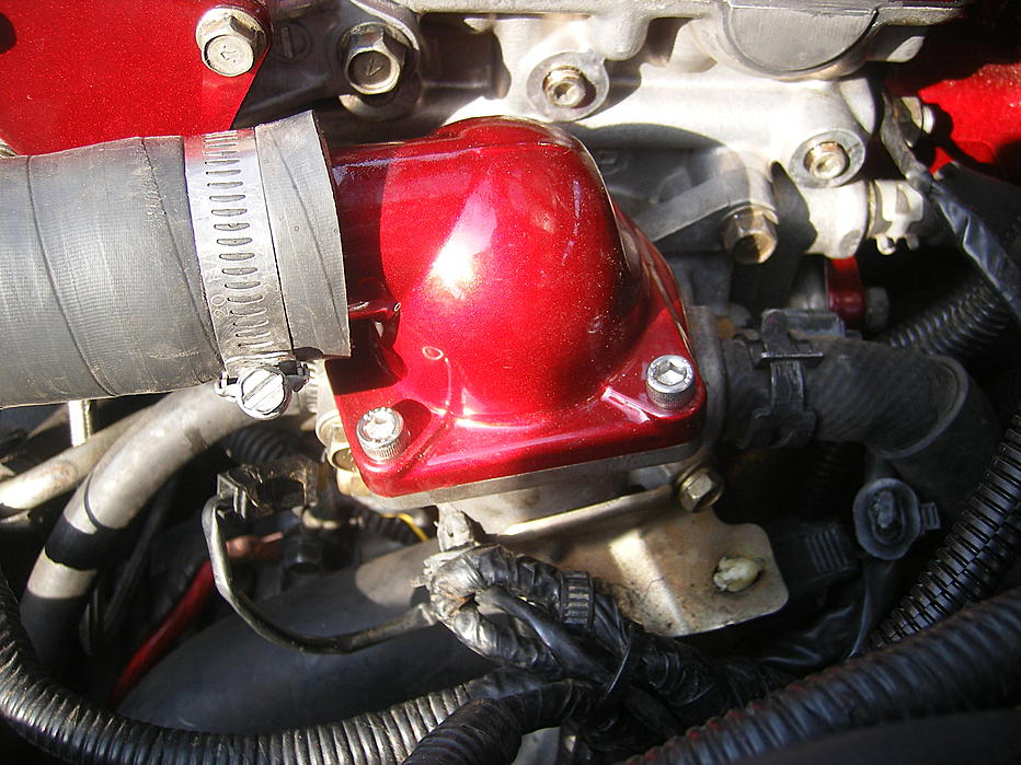

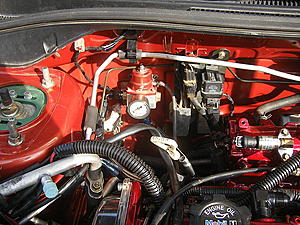

So a couple of progress photos, adn an update.
After a new starter and a mysterious oil leak behind the intake manifold (machine shop left our a screw plug) she is alive.
I defiantly need to work on the tune a little but it's not bad.
Thanks to Ryan for the great work!

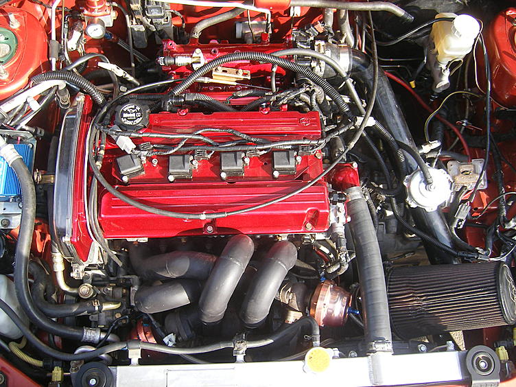

1 more

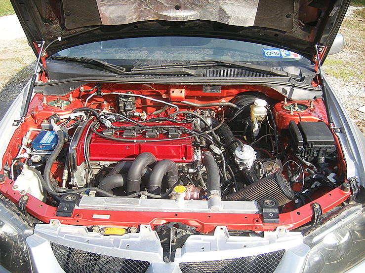

Alright i understand u spend all the extra cash on looks for the engine bay which is good, but if ur gonna spend that money and then make a mess of wiring to ruin the look whats the point?
Old Oct 13, 2010 | 02:40 PM
benderrodriguez's Avatar
iTrader: (26)
Joined: Apr 2010
Posts: 287
From: Starkville
The wiring still needs to be cleaned up. the car overall is far from done we just wanted to get it running to see if there are any mechanical issues. Eve from a reliability standpoint I'm not going to leave loos wires hanging.

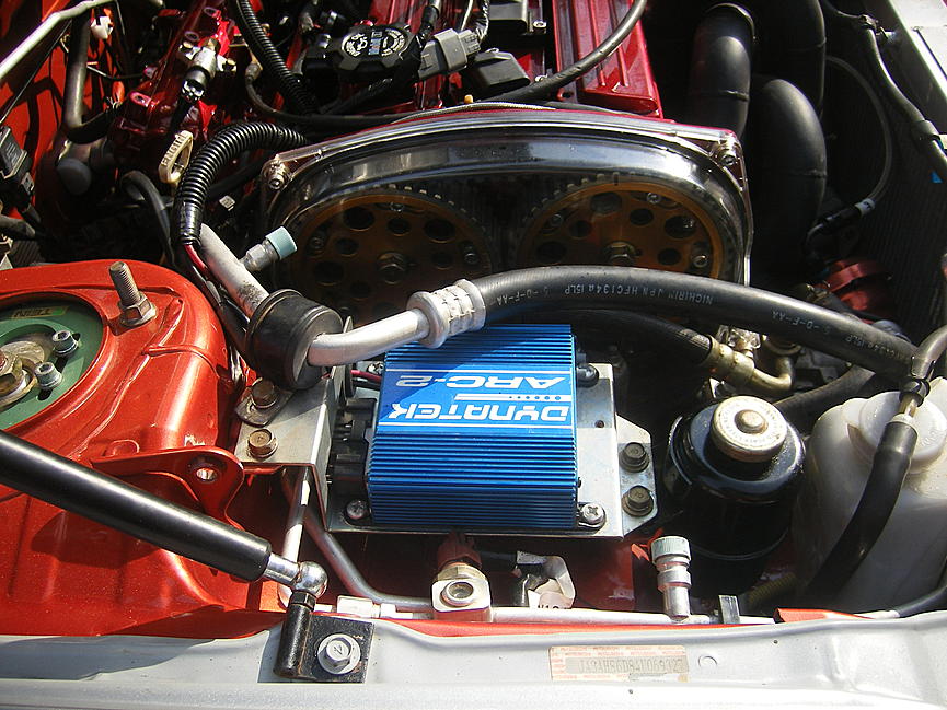

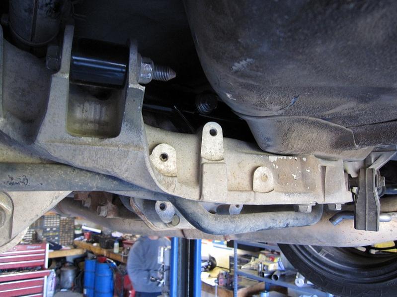

I'm hoping to finish up the wiring and the paint job in two to three weeks. In the mean time here are some progress pics of the new fuel filter, catch can, mustache bar, front cross member, and battery
