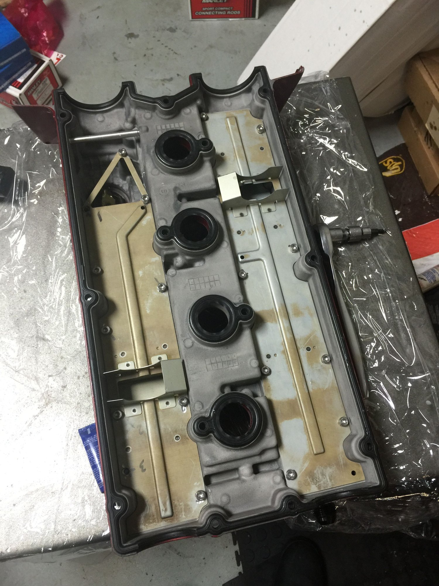

This is what the baffling/valve cover looks like inside for those interested. Its very easy to clean with baffles intact and don't let it scare you from doing so.
Just keep in mind once again the material of the cover is NOT magnetic, so if you leave stuff behind, you will risk damage from magnesium shavings.

These pictures I'm about to post below are to motivate others that like to "DIY" on everything they own to tackle the project themselves WITHOUT removing baffles.

Did you have to drill and tap all the holes to remount the baffling? I had my VC painted and I'm a bit concerned that theirs some sandblasting media still in the baffles even after cleaning for a few hours...

If it was sand blasted i would not even attempt to use it in my car. Baking soda would be ok though or non abrasive media blasting.
Sand embeds itself and its almost impossible to get all media out once its done from what I've researched.

Yikes. Thanks for the heads up. They sandblasted the outside before painting it & I cleaned it like a **** afterwards, but I was worried about inside the baffling. I guess in the end I gave myself a good excuse to get a JDM cover.
This one was drill and tapped yes.

I respectfully disagree re: leaving baffles in. I've done half dozen covers now (both my own car and friends). The swarf is super sharp so it embeds itself in all crevices. Only way (I've found) to ensure its clean is a chemical bath
Perhaps the vendors on here have a special cleaning method to fulfill their guarantees but I greet the baffle in method with skepticism
Below pics to illustrate the amount of swarf you will be dealing with:
If you do decide to remove the baffles you're faced with the problem of picking up the centre of the existing rivet; a little tool like this will do the trick. 100% accuracy every time

i drilled mine out upside down. didn't get that much in there. and any that did get in, stayed close to the hole. also tapped it upside down.
drilling and tapping for the baffle, you still run risk of screw backing out and end up in the motor. unless you tack weld the crew to the baffle.
