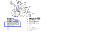

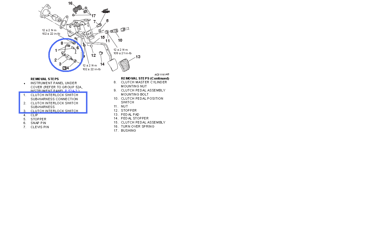

While it is possible that the issue might be with the Clutch Interlock sensor as you mentioned, I don't think it is very likely based on my past experiences (pic attached of sensor)
It's very likely that your ECU will not throw any code, so to keep expenses to a minimum try starting with the Crank angle sensor (this sensor is harder to get to so you might want to take your car to a shop.) .... Replacing the Crank angle sensor should resolve the problem, but if it does not then the next step would be the Cam angle sensor. (In the Evo the Cam angle sensor is very easy to get to and can be done in ~5 min, it should be equally accessible in the OZ version too.)
