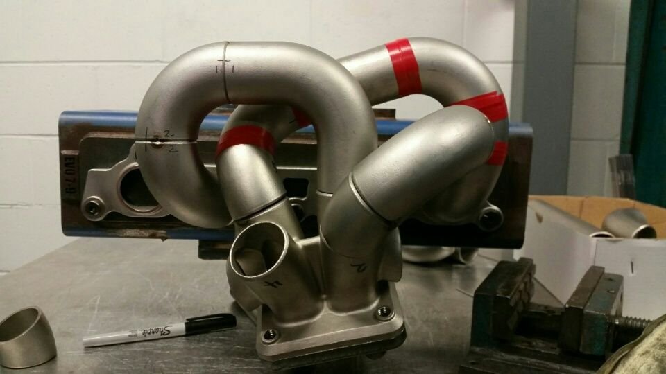

Agree. ~$4K is out of reach for most guys when you can make the same peak numbers with the stock frame stuff. EFR's also seem to be primarily used in Motorsport applications, motorsport guys aren't often forthcoming with data/info so this could also explain why we don't have a larger pool of data.
Hopefully have some results of my own to share soon, new 'tilted' manifold will alleviate some of the issues fitting a nice 3.5" - 4" dump (most other set ups I've seen require an asthma inducing bend off the back of the turbo).

Very nice looking manifold! Are you building this for b1 or b2 frame EFR turbos?

Is that the hypertune cast collector?

Wondering what collector that is as well.
