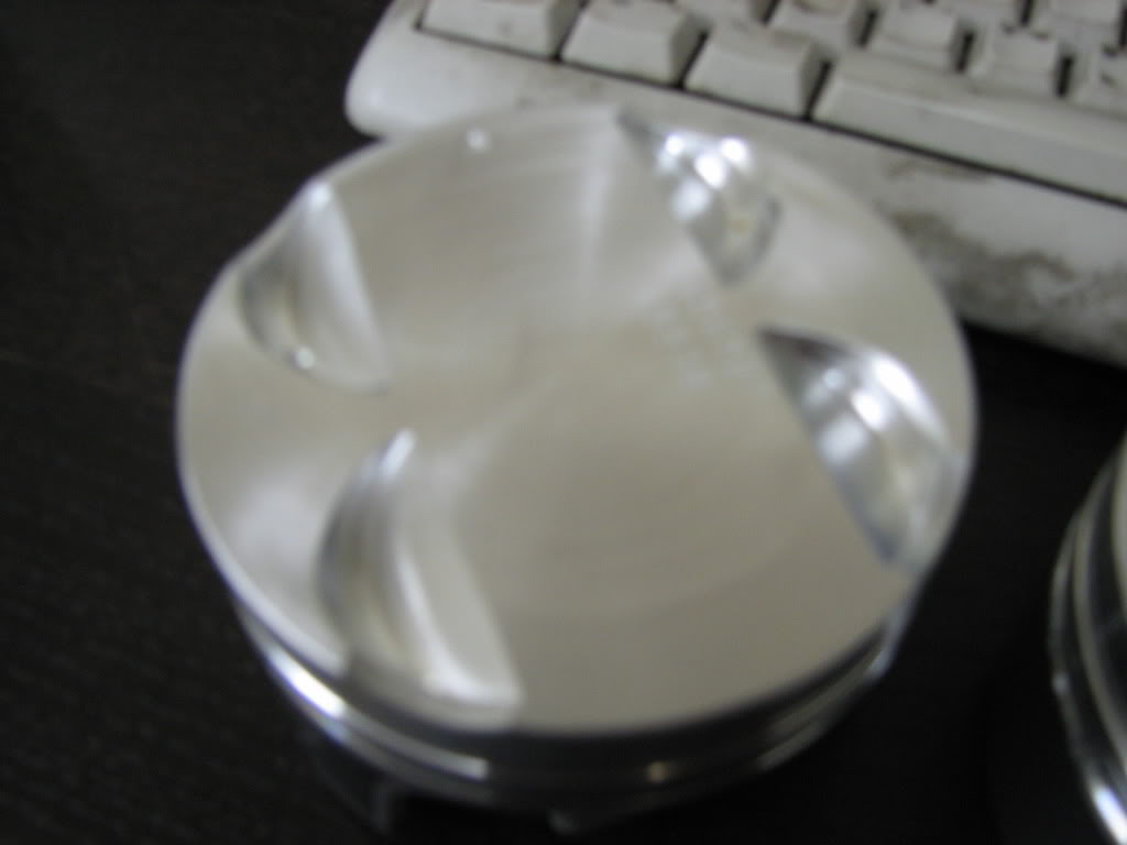

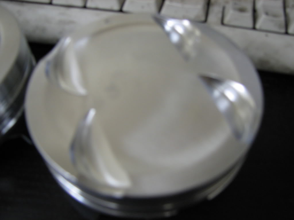

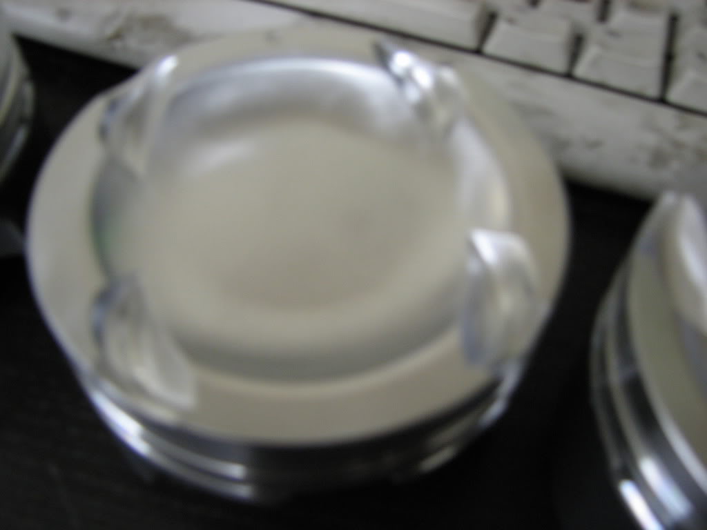

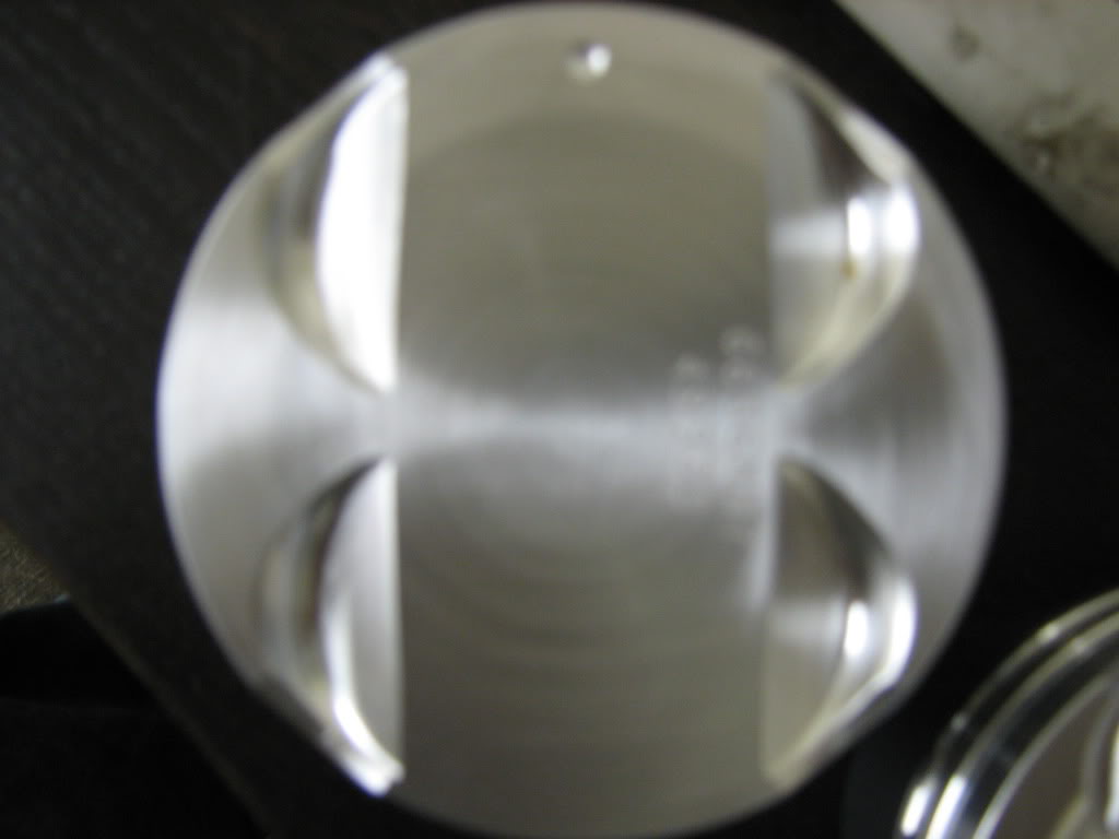

Guess my compression based on apparent dish/dome (all pistons are 87mm Mitsu)-
1.
2.
3.
Old Jul 14, 2011 | 04:47 PM
  #143
JohnBradley's Avatar
iTrader: (30)
Posts: 11,406
Likes: 78
From: Northwest

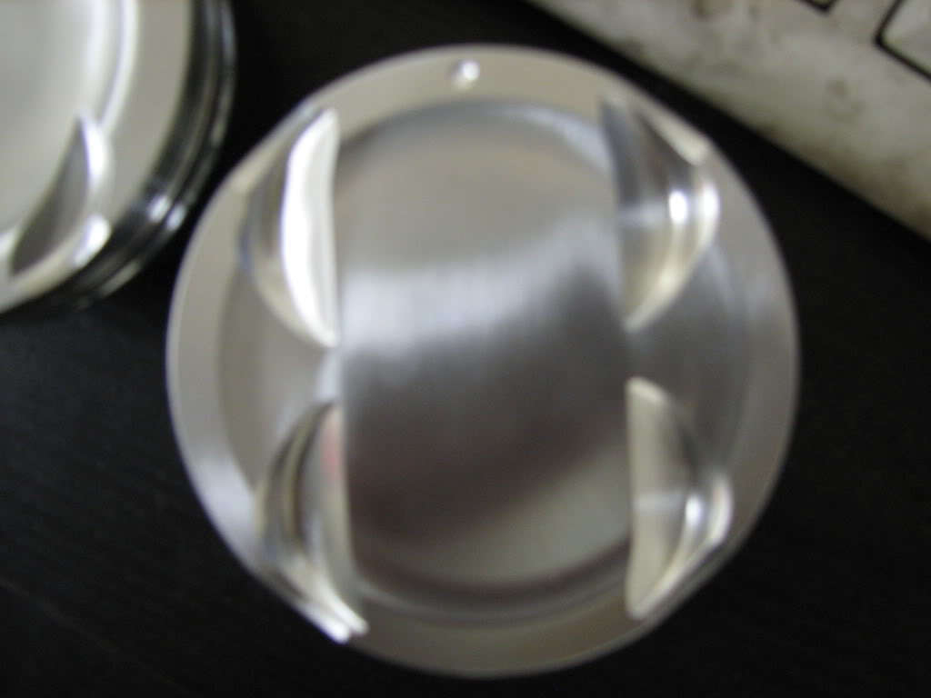

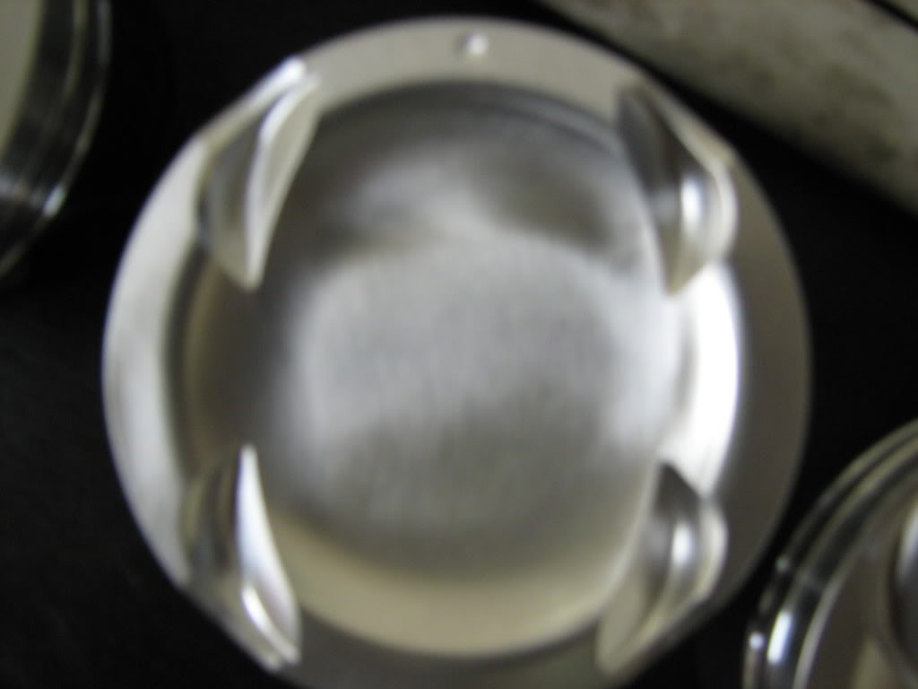

Pistons are in the same order

1--10
2--9 or 9.5
3--11 or 11.5
Old Jul 14, 2011 | 04:55 PM
  #145
b16a2delsol's Avatar
Posts: 338
From: killa streets of slc
9.5 , 8 , 10.5
Old Jul 14, 2011 | 05:55 PM
  #146
RSMike's Avatar
Joined: Jul 2009
Posts: 2,276
Likes: 372
From: New Zealand
10.5, 9.5, 11.5

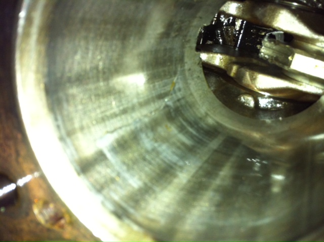

Found the problem!!!!!

The correct answers are-
1. 11:1 LR 2.4 piston (custom)
2. 9:1 LR 2.4 (custom)
3. 10.5:1 SR 2.4 (off the shelf)
All Wiseco.
The reason is the compression height and engineering for the headgasket we choose to use. I used them as examples since just looking at a piston is a very small part of the equation. The head could have been milled .040" (actually just saw this) and someone failed to tell the tuner that he was now dealing with a motor that was over a full point higher compression and the cam timing is advanced.
There is physical damage to the piston without valve contact evident. To me this is a valve breaking off and slamming the rod stopped. I wanna see the combustion chamber for #4 really bad.
