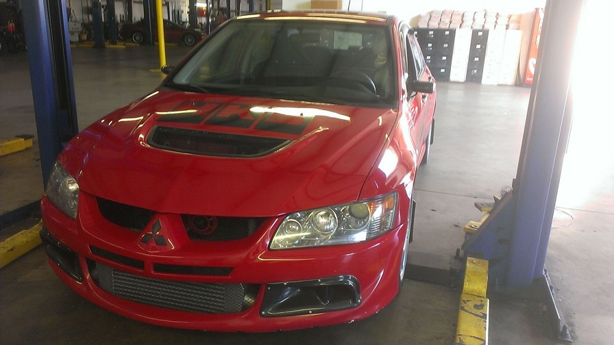

And if anyone cares here is the painfully identifiable feature (now removed) of the car:
