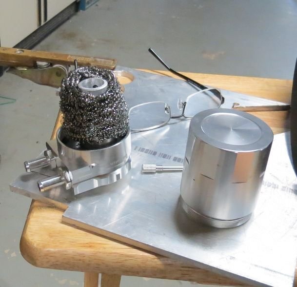

I know I am late to the post, but here is another option.
I run those cans on my GTR and with a simple mod they work quite well. I simply welded a perforated tube to the inside of the can and then wrapped it with a stainless scrubby from Walmart. This forces the oil vapor to the bottom of the can and then up through the stainless scrubby, which condenses the oil and only allows the air to vent. The condensed oil then falls to the bottom of the can. You can get them on Amazon for ~$25/per. This is not what I run on the EVO, but definitely a cheap can option if you have the ability to modify.

I pretty much open up the cap (section you weilded/extended) and put the stainless scrub in it.
Your looks like a better idea, I might do that in the future. Cheers
