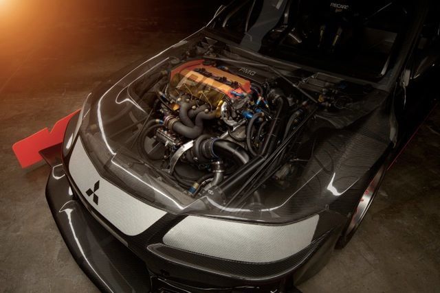

Which manifold places the turbo closest to the driver side?
Ideally I'd get a tilt one like this to do a bigger DP

First thing to come to my mind is Cbrd lmp style manifold. but thinking that it's custom..

Are you interested in the look of that over function?
People have made around/over 1000whp with a std placement turbocharger and downpipe.
If you go down that path don't tilt the turbocharger over 15* to be on the safe side .

No I am doing this so I can get a 3.5 inch dp bend that wont be as sharp of a bend hitting the ac compressosr.

Check out some top mount setup.
http://www.full-race.com/store/efr-s...bo-kit-1.html/
