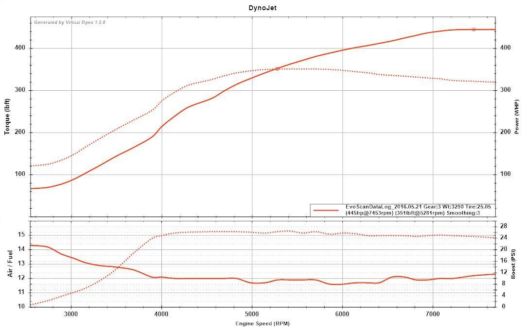

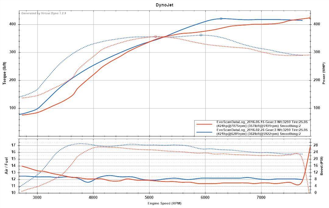

Here is a dyno chart of my old HTA 71 (blue) vs the Green I have now (red), since you mention looking for a green. This was before tuning, but shows spool characteristics of the two, as well as the decreased boost needed to make the same power. Your IX turbo will spool even faster, but make less peak WHP. I preach the HTA71 being the best street turbo for our 2.0L, any chance I get LOL
Here is my conservative track tune. This is on the MHI housing, I'm told SS spools slower but makes more peak power; similar to an MHI red, as others have stated in this thread. There's more in it, but I'm not looking to tow the car home LOL

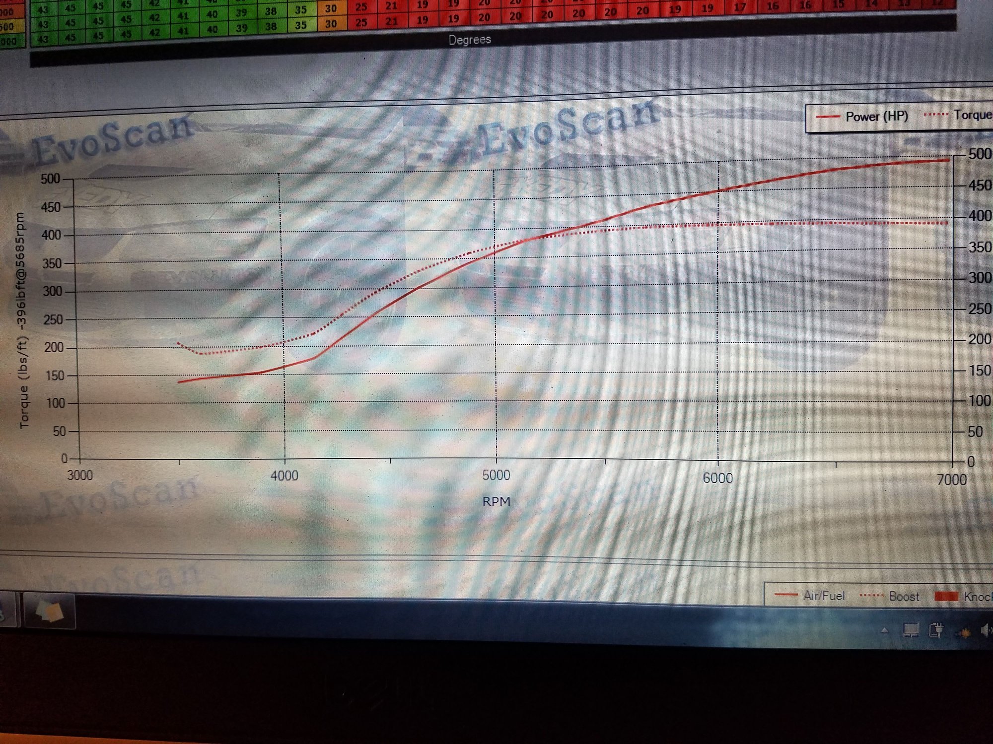

My log at 28 psi.
493 hp 396 torque

I was wondering as well when I saw the 12:1 afr across the board! I figured that's not so conservative for a road course car on pump gas haha.

Originally Posted by 4b11slayer
My log at 28 psi.
493 hp 396 torque
Single scroll red? That lag though. Gotta get on the twin scroll life.
yes single. I wouldnt spend on a twin red. Because if i buy new turbo hopefully it will be a 6466 or something. The lag sux but it still pulls hard. Although it is true my evo 9 turbo felt more torque.

That is a far-to-the-right power band for sure. I wonder what it would look like if it were started at say 2k-2500k rpm?
Letsgetthisdone, that looks like a nice MD graph on the bottom! Peak torque looks to be in the same area as my smaller turbo! Must be fun around town.
