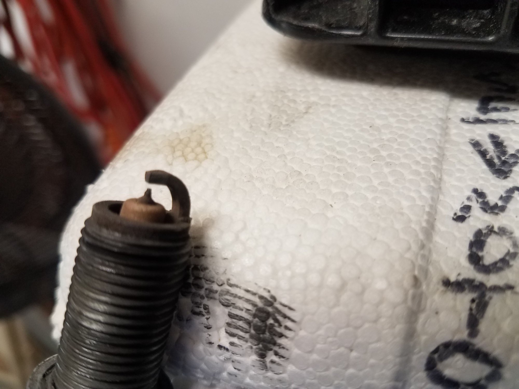

did you check the plugs?
sounds like bad plugs...

Plugs wont cause that drop in load that you have.
All four plugs. Three where gapped at .22, one was .25+
Looks like the iridium tips are still on all four.
I swapped in some Denso plugs I had laying around. DC'ed the battery for a while to reset the ECU so it can relearn the MAF.
We'll see.
Dude. Those plugs look like they have 30k miles on them. Did you not replace them with the short block? You told me they were new on FB chat...LOL
Also, you're using WAY WAY WAY WAY too much anti-seize on the plugs. You only need a dab. It spreads well.
Densos are gapped at .22 and in. Still no change.

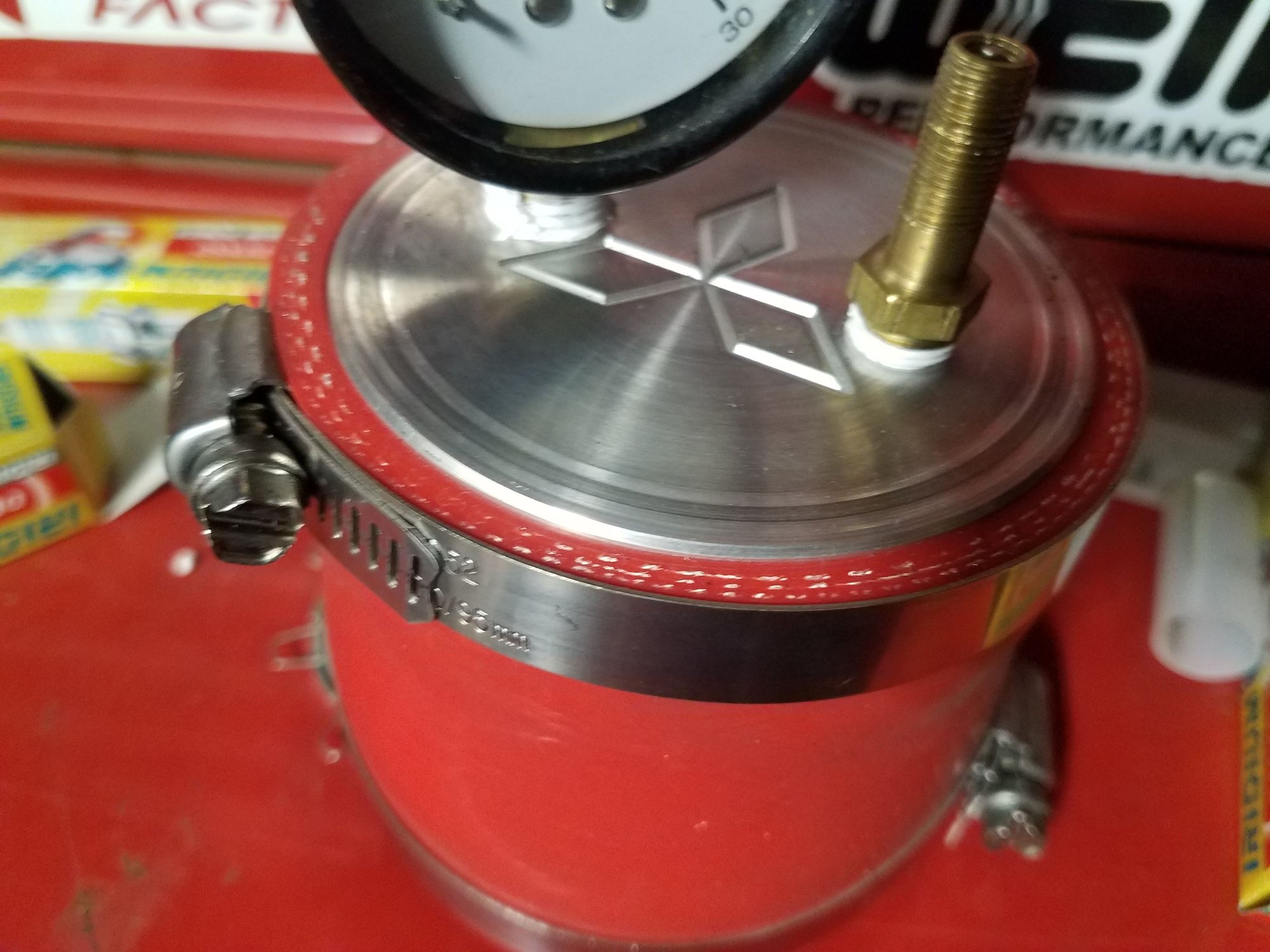

Cmon man, use a boost leak tester, I thought ive checked all lines before too. I highly recommend http://turboboostleaktesters.com/evo...big-16g-turbo/
Great product and customer service!
plus, I made my tester and I think it's prettier.
