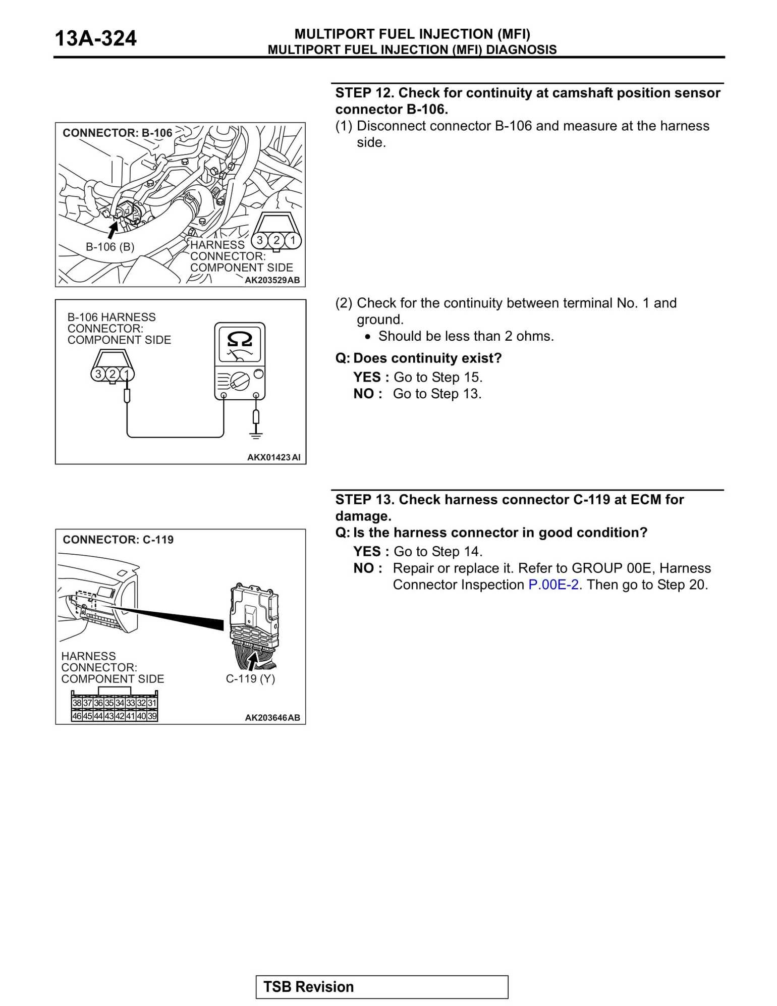

Yeah I actually have it all on lap top. THe shop manual. we ran threw many diagnosis's. All coming back to bad ecu. So I got a new/used ecu and it fixed the no grounding to the mfi relay. car cranks really good with it too.
I printed both manuals out. I have about 1500 pages worth. lol

in that case its starts at 13A-246
