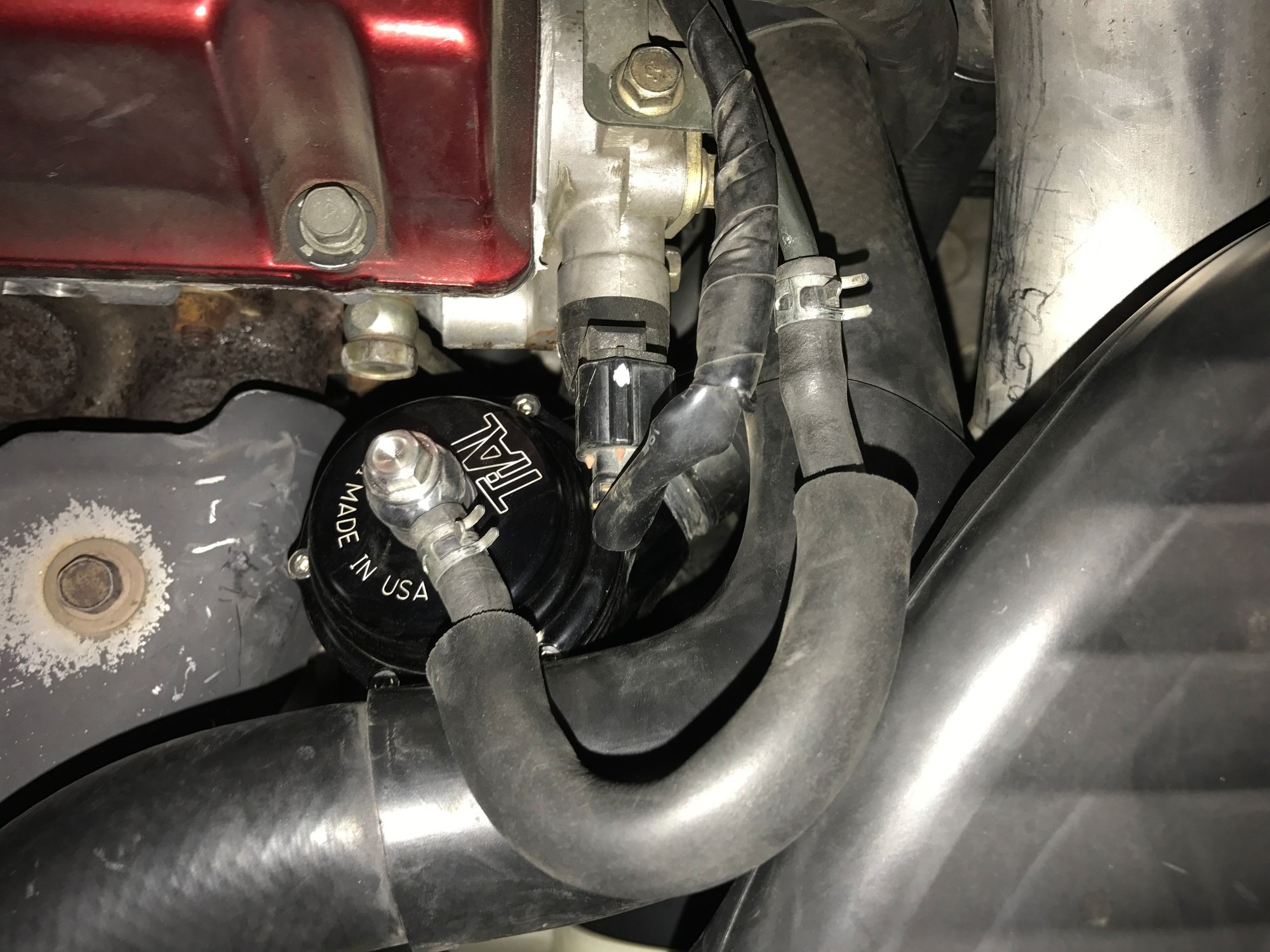

I purchased the QRJ but there's no solid diagram or instructions that come with the bov. I have seen pictures of it being installed both ways, so which way is the correct way? Currently I have it like this (opposite of the OEM valve orientation)

In your pic, the port point down is the outlet (to intake pipe), and the port point to the charge pipe is the inlet (to charge pipe).

Correct. Is that the right orientation? The OEM diverter valve is opposite of that, with the inlet being where the valve seats, and like every other bov I've seen. I have seen this valve being installed both ways so I don't know the correct one

Yes, that's the right way. If it wasn't I wouldn't have called the ports what I did.

Got it. Thanks for the help!
