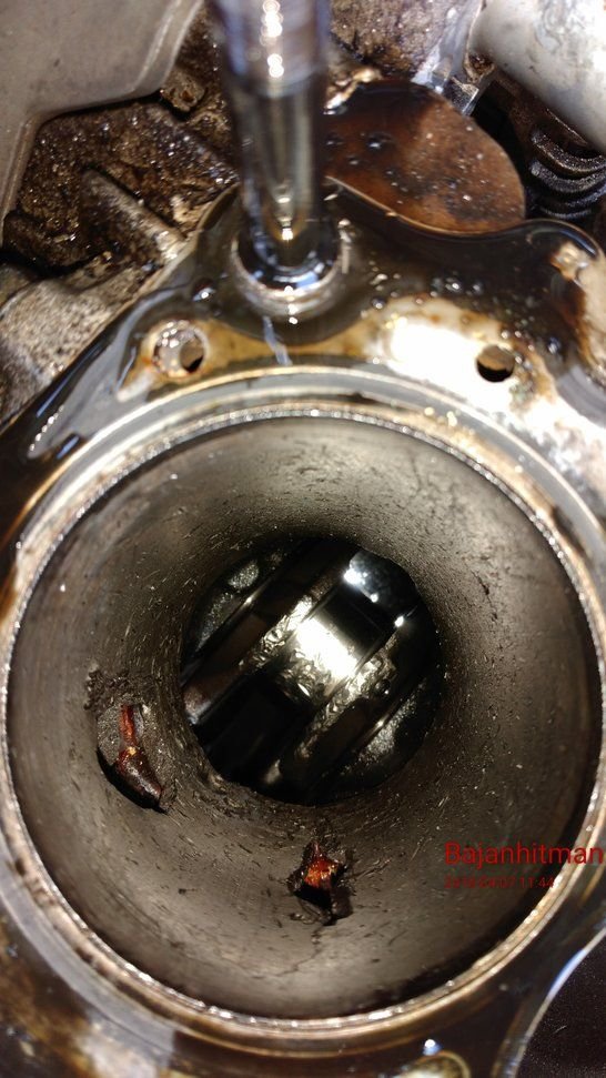

Someone pointed me in direction of this tread. Was a stock 2l with fuel pump, exhaust, ic piping, intercooler etc. Think she had a bit too much torque and rod bolt let go. So fully upgrading to a forged 2.4 long rod

Rod bolts break from RPM's generally.

Look at that head. Cylinder 1 really took a beating. Are you able to reuse your head?
Will it happen if you run the stock limiter? I have bolt on's and hit the rev limiter here and there at Autocross.
Then the rev limiter is doing it's job and saving your engine

Posts: 15,973
Likes: 1,629
Stock rod bolts will handle 8k. I wouldn't slam the car off the limiter for 20 seconds and hop she holds though. A few popes off the limiter isn't gonna hurt it though. Rod bolts can also fail when the bearing spins and tries to lock up the motor up, not necessarily just from RPM. The force pull the bolts apart.

That head is barely hurt, easily reusable.
