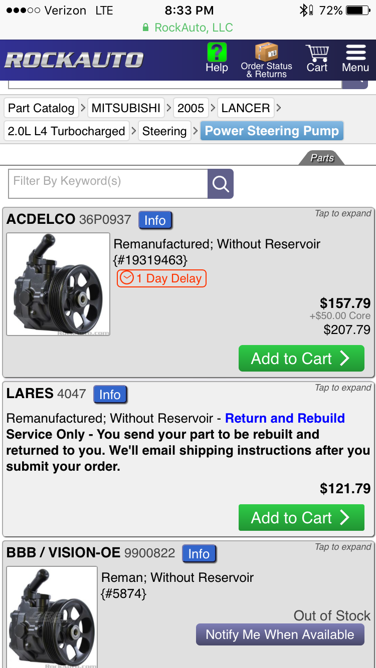

Yeah, so we listened to the PS pump, and it sounds like it's the loudest, but I can't really get near the idler pulleys to test for that. The fluid is fine, we checked the level and it seems to be a-okay.
If it ends up being the PS pump, where would I get a new one? I seem to have difficulty finding a vendor that sells the part? I see many selling the reservoirs for the fluid, but not the actual pump.
