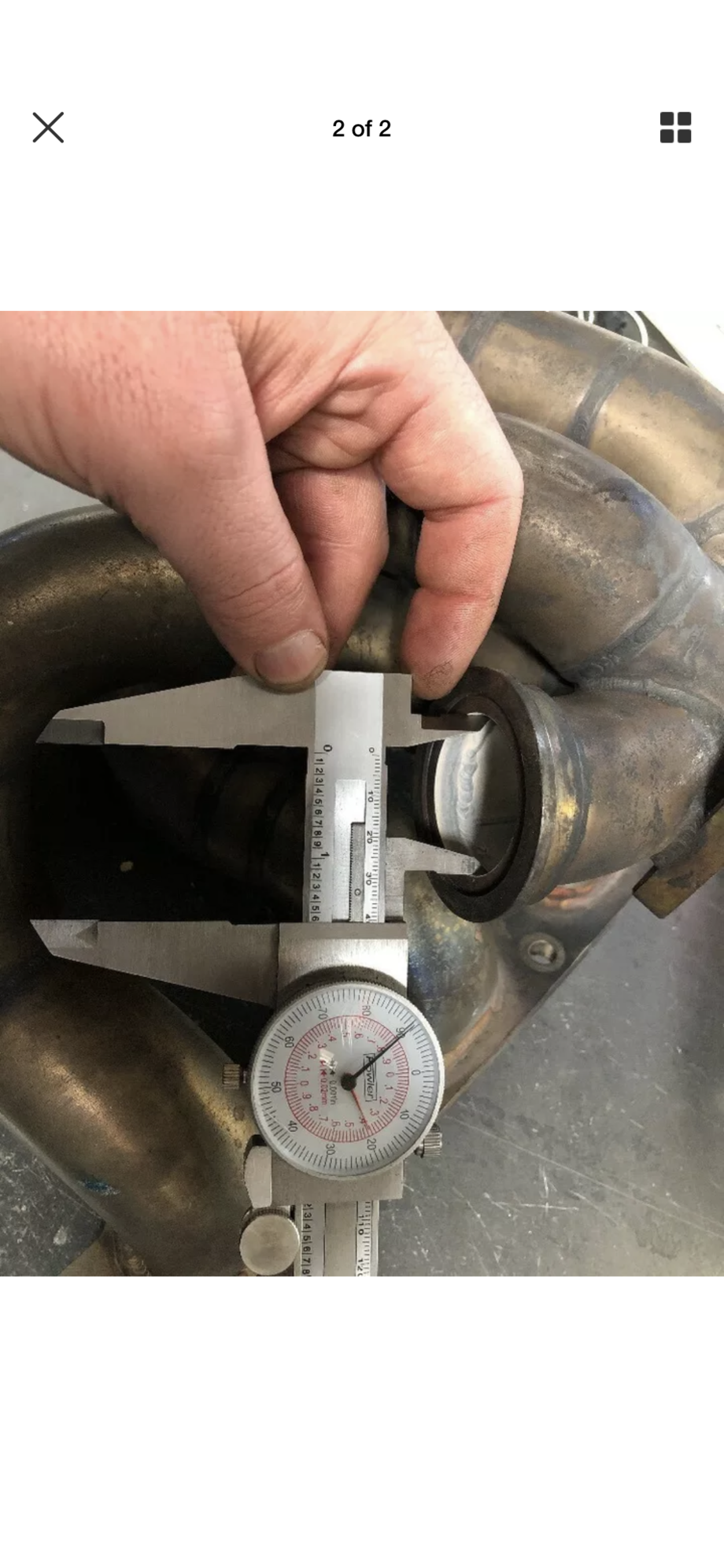

Hello im a newbie on the forums and have recently purchased a ron shearer manifold. Im confused on what size wastegate i need to purchase. The inner diameters seems to be 40mm and the outerdiameter seems to be 63mm. Asking for help.

Tial MV-R 44mm and Turbosmart 45mm both have a flange od of 63.5mm.
