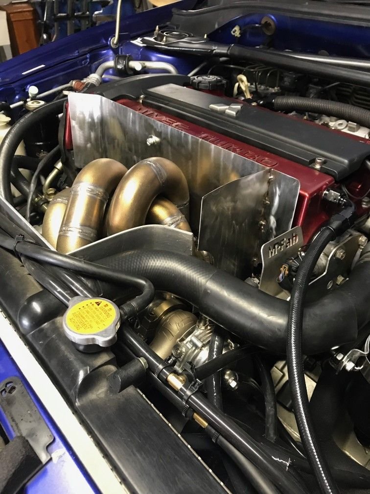

ideally you want 2400cfm from the fan (puller) in order to remove the heat. Likely the 1200cfm just can't pull enough heat from the radiator so you are on the edge. To the extent you can, force the fan to draw in cooler air from the front of the car instead of heat coming from the engine bay. This will likely require that you make an aluminum shield on the header side of the radiator to block it from ingesting engine heat. Also, make sure, to the extent you can, seal the radiator with foam around the edges between the radiator and front cross member to limit hot engine air from entering the radiator. All of these little things help a lot.
See the foam in my pic below that I purchased from Lowes that seals the radiator edges so it can't suck in engine heat.

With the Koyo Half radiator the biggest fan that I can seem to fit is a 13" fan and I have only found puller fan to provide around 1300cfm. And I have solved my issue but thank you for the information. Your set up looks very clean.
