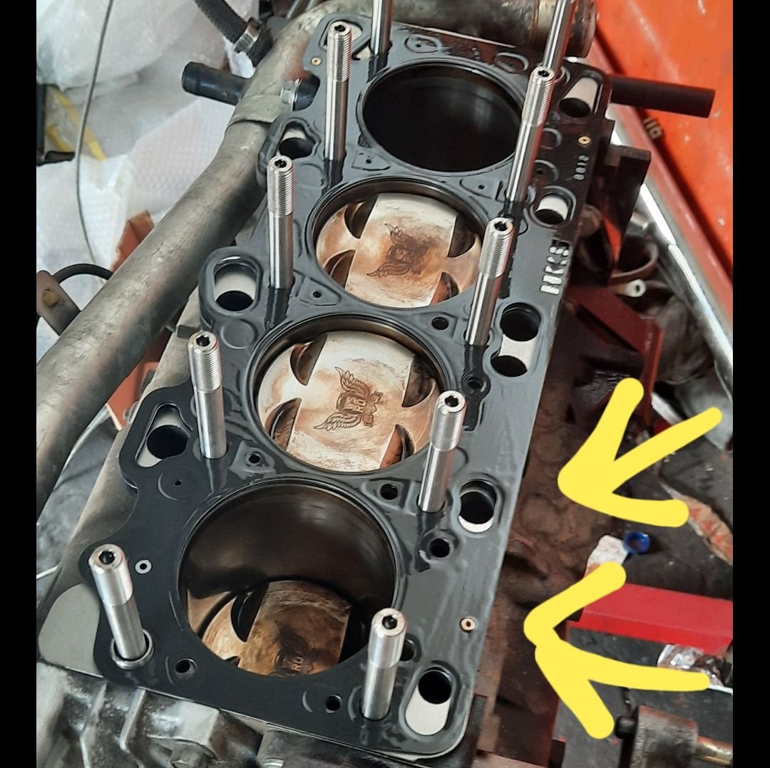

I dont now what's going on. What can this smoke be...as there was never coolent on my car always water so it cant be burning coolant...but the shop did put oil on my hose gasket for some reason before installing which I have a pic of...maybe that oil burning is what causing the the smoke

Why did he put oil on the head gasket? Oil is non-compressible, which is why it is used in hydraulics so not sure how the head gasket would properly seal. I've always put them in bone dry with the exception of the metal HKS head gaskets for the L28 Zcar motor, which I sprayed copper seal first.

I'm not sure why he did that also...this is the hks metal headgasket which is installed as you can see in the pictures
We torque too 105 lbs altho 100 lbs was needed...so I dont know how sealing of the engine would be effected

The head gasket should be installed 100% dry or with copper seal only. Idk why he oiled it, but I'm betting that needs redone. It would be effected because you now have a layer of oil, which is not a sealant, between the gasket and deck surfaces.

Just wipe down the surfaces of the block and head with some acetone on a lint free rag and you should be good with the fresh dry gasket. The copper spray wouldn't hurt, but if the gasket comes coated then likely not needed. I've re-torqued the H11's 4-5 times.

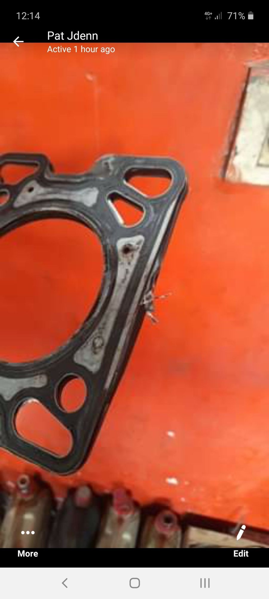

well this peace of metal was sticking out of the gasket , dont know what caused this so I taught it would be better for my peace of mind too change it a hks one.
ah, bummer. But "if it ain't broke..." :P
Doesn't look like that was on any part of the sealing surface, but no way to know that until you looked. Dang, man. On the bright side, at least your mechanic 'fessed up so you know what's wrong. Git 'er done! Good luck, dude.
